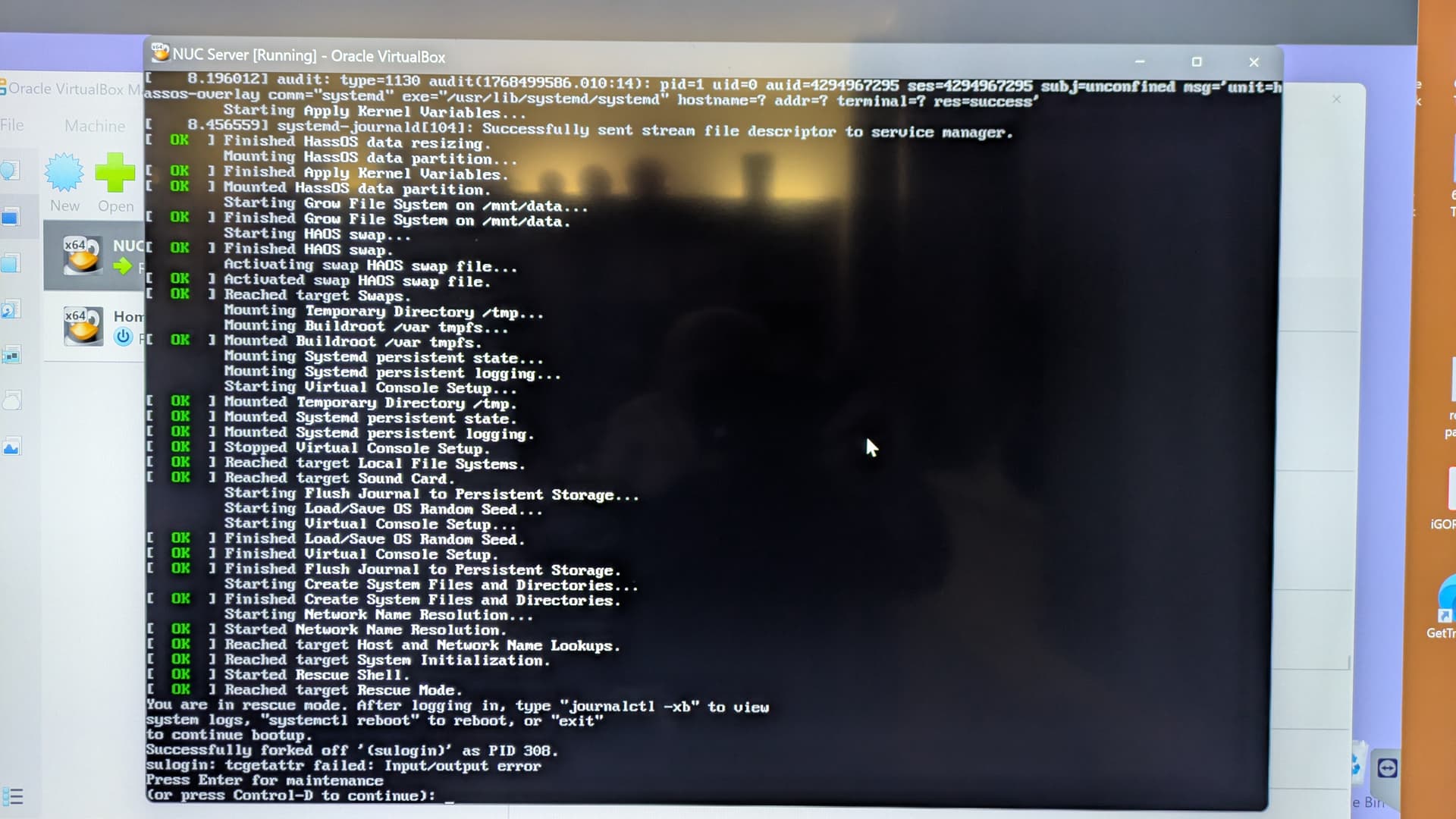

Here are two screenshots> The first shows it booting into rescue mode…

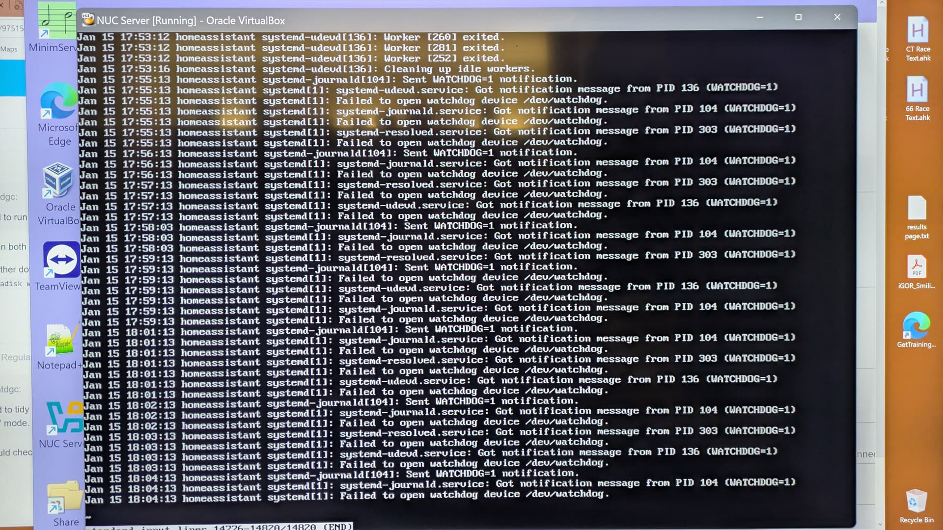

And this on is the last page of the journalctl -xb command…
I suspect the 'Failed to open watchdog device /dev/watchdog" is a clue but meaningless to me.
