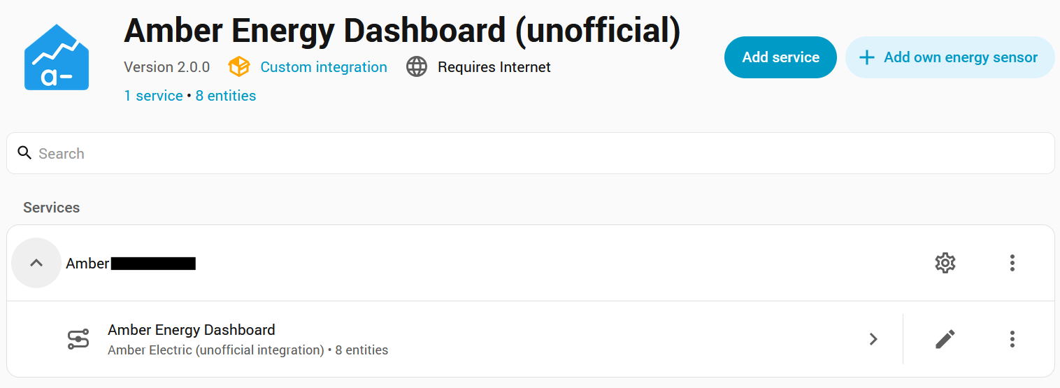

Tested end-to-end on two separate instances (one HTTPS/DuckDNS setup, one plain HTTP LAN instance) — the README’s troubleshooting section covers the real gotchas hit along the way, including a subtle statistics-corruption bug that took hours to manifest, so hopefully nobody else has to rediscover that one the hard way.
Repo: GitHub - r5e/ha-amber-energy-dashboard: Get Amber Electric usage into Home Assistant's Energy Dashboard, daily and backfilled · GitHub
I’m by no means an expert, and this is my first time putting something like this together — I had Claude help me extensively along the way. If people find this useful, I’m considering spending more time packaging it into a proper integration with fewer manual steps and less YAML-wrangling.
Feedback welcome, especially from anyone with a Controlled Load tariff — I haven’t tested against one and the script would need a small extension to handle that channel.
Version 2.0 is out: now a proper HACS integration

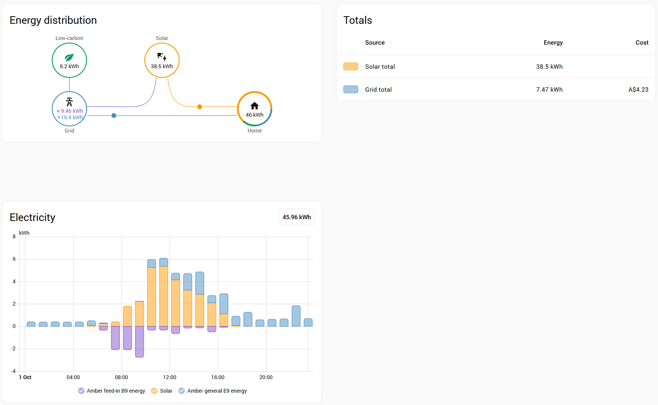

New in 2.0
  • Hourly import and export energy with real per-interval cost and feed-in earnings
  • Automatic backfill of everything Amber still holds (about three months), and automatic catch-up after outages
  • Revision handling: if Amber revises estimated days, history is corrected
  • Controlled load support, detected from your site
  • Optional: price your own energy sensors (CT clamps, smart plugs) at Amber’s real 5-minute prices
Accuracy: checked against a real monthly Amber bill, energy imported and exported match exactly, and import cost matches to the cent.

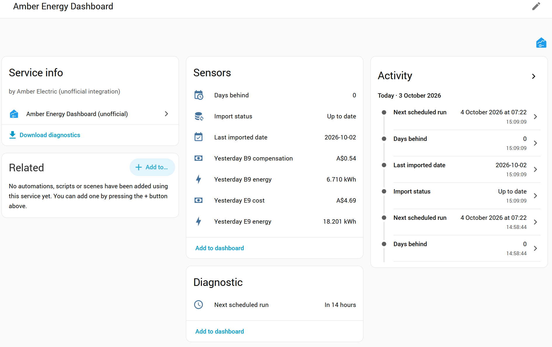

This is cool!
I haven’t had much success getting it working for me however, I’m just stuck on the “waiting_for_data” status. Looking at the diagnostics, it appears to be checking for data on 2026-07-11 (which was a date where I was not with Amber), so it keeps failing. Maybe the integration could check for the most recent dates first and then go backwards?
It is meant to. Are you using the latest 2.0.1 vers? Did you have the older v1 installed before that? If you can send me any logs or diags I might be able to help. Drop me a private message and I’ll see if I can help.
Actually, there is a bit of a gap here for new users and I think I know what the issue is. I was about to release a v2.1 tomorrow, but I think this fix needs to go into this as there will be other new Amber users (having less than the full 90 day history) and it may also have problems for them.
There is a possible potential work-around: Go to Developer Tools > Actions, run amber_energy_dashboard.probe_retention once. This will force a fresh search for the earliest day with data and this might find the real start date and allow the import to proceed from there. If not, in a couple of days I should have this rolled into the next release. Additional info would help, so PM if you can, otherwise wait for the update. I’ll post here when it’s ready but I’ll be keen to know if it works in the wild.
I just tried the probe retention action and it found the latest date. I then did the full import and it worked! I can try and assist with any logs, just message me with what you’d like!
Really glad that worked! Should have this fixed properly in the next release soon. Have PMed you a request for the diagnostics, just to be sure.
BTW (for anyone else who may need to do this) - the diagnostics file already has any identifiable data (API key, NMI) redacted so it should be safe to post. You can download the diagnostics file under Amber Energy Dashboard (unofficial) >Service info. This should then contain the info needed to properly fix it.

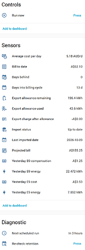

Version 2.1.0 is out

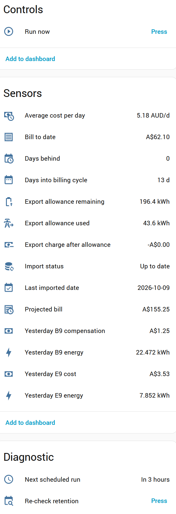

New: bill estimate. Set your billing day and your bill’s daily charges (the guide shows exactly where to find them on an Amber bill), and the integration shows your bill to date, a projected bill, and the average cost per day. On my September bill it came within 3 cents of the actual bill, excluding a one-off card fee.
New button to poll Amber now if you’re too impatient to wait for the schedule. New Diagnostic button in case there are retention problems.
Loads of new useful sensors related to billing which will become more useful in the next version.
New: export allowance (two-way network tariffs). Some networks charge for midday exports, but only beyond a free allowance applied on the bill (for example Endeavour Energy’s N61: 8 kWh a day, over the billing period). Amber’s usage data charges every exported kWh in that window, so feed-in earnings looked lower than on the bill. The integration now detects the tariff automatically, measures the charge from your own data, and provides an adjusted feed-in compensation that matches the bill, plus sensors for the allowance used and remaining. Endeavour N61 is built in; other tariffs can be configured by hand.
Easier setup:
  • An “Add to the Energy dashboard” option at the end of setup, and a Repairs notice if the dashboard isn’t using the integration yet.
  • Run now and Re-check retention buttons on the device page.

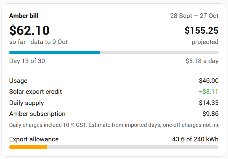

Also just added a card to better showcase some of the new capabilities. The next version will also have extra items to show you last bill etc.
Lots more to do still, but thought it worth sharing in case it’s useful to anyone.
If anyone wants to use it, create a manual card on your dash and paste in this yaml:

      return `
        <div style="font-size:var(--ha-font-size-m,14px);line-height:1.45;">
          <div style="display:flex;justify-content:space-between;align-items:baseline;flex-wrap:wrap;gap:4px;">
            <span style="font-weight:600;">Amber bill</span>
            <span style="color:var(--secondary-text-color);">${cycle}</span>
          </div>
          <div style="display:flex;justify-content:space-between;align-items:flex-end;margin-top:6px;flex-wrap:wrap;gap:8px;">
            <div>
              <div style="font-size:var(--ha-font-size-3xl,28px);font-weight:600;line-height:1.1;">${money(bill)}</div>
              <div style="color:var(--secondary-text-color);">so far${through ? ' · ' + through : ''}</div>
            </div>
            <div style="text-align:right;">
              <div style="font-size:var(--ha-font-size-xl,20px);font-weight:600;">${money(proj)}</div>
              <div style="color:var(--secondary-text-color);">projected</div>
            </div>
          </div>
          <div style="height:8px;border-radius:4px;background:var(--divider-color);margin-top:10px;overflow:hidden;">
            <div style="width:${pct}%;height:100%;background:var(--primary-color);"></div>
          </div>
          <div style="display:flex;justify-content:space-between;color:var(--secondary-text-color);margin-top:4px;">
            <span>${isNaN(daysIn) ? '' : `Day ${daysIn}${daysTotal ? ' of ' + daysTotal : ''}`}</span>
            <span>${isNaN(avg) ? '' : money(avg) + ' a day'}</span>
          </div>
          <div style="margin-top:12px;border-top:1px solid var(--divider-color);padding-top:8px;">
            ${rows || '<div style="color:var(--secondary-text-color);">No breakdown available.</div>'}
          </div>
          <div style="color:var(--secondary-text-color);font-size:var(--ha-font-size-s,12px);margin-top:4px;">
            ${gstNote} Estimate from imported days; one-off charges not included.
          </div>
          ${allowance}
