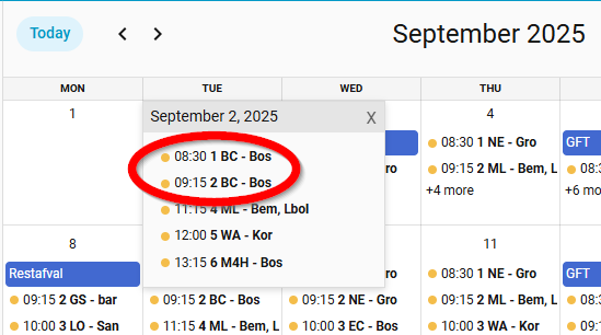

@Emphyrio I have a specific request. My son has an exemption for a certain subject (“BC”) at school, but that subject is scheduled as first lesson on Tuesday’s — and that’s what the alarm is based on.
Is it possible to adjust/extend the template sensor so that when the first lesson is “BC,” the nextup_lesson sensor ignores that and uses the next lesson after that on that day as the output of the nextup_lesson?
For example, I could add this line in the template sensor:
| rejectattr('attributes.summary', 'search', 'BC')
Or do you suggest another way?

Sounds good, just give it a whirl :slight_smile:
Just did, and it seems to be working. Initally I used the wrong quotes: ‘ (curly single quote) instead of: ’ (single quote). Took me some time to discover that mistake :smirk:
Corrected the syntax in my initial suggestion.
