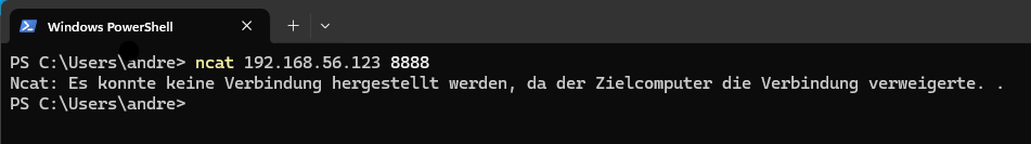

Hi @chrizzzp
I was able to install ncat on Windows:
PS C:\Users\andre> winget search nmap
The source "msstore" requires that you view the following agreements before use.
Terms of Transaction: https://aka.ms/microsoft-store-terms-of-transaction
The source requires the geographic region of the current computer to be sent to the back-end service in 2 letters for it to work properly (e.g. ‘US’).
Do you agree to all terms of use of the source?
[Y] Yes [N] No: y
Name ID Version Source
Nmap Insecure.Nmap 7.8 winget
PS C:\Users\andre>
PS C:\Users\andre> winget install Insecure.Nmap
Found Nmap [Insecure.Nmap] Version 7.80
This application is licensed to you by its owner.
Microsoft is not responsible for and does not grant licences for third-party packages.
Download is running https://nmap.org/dist/nmap-7.80-setup.exe
 ██████████████████████████████ 25.6 MB / 25.6 MB
The installer hash has been successfully verified
Package installation is starting...
Successfully installed
PS C:\Users\andre>
Unfortunately I could not establish a connection to the HA PC:
Why is the connection deniedPreformatted text
Sorry, this is beyond my knowledge. I also use HAOS and connecting to ebusd by Windows ncat from the Nmap package works. Check that the ‘TCP client port’ in the ebusd addon configuration (HA) is the same that you use to connect to (default 8888).
However, in the meantime I would check whether the “missing entities” are visible in MQTT Explorer.
