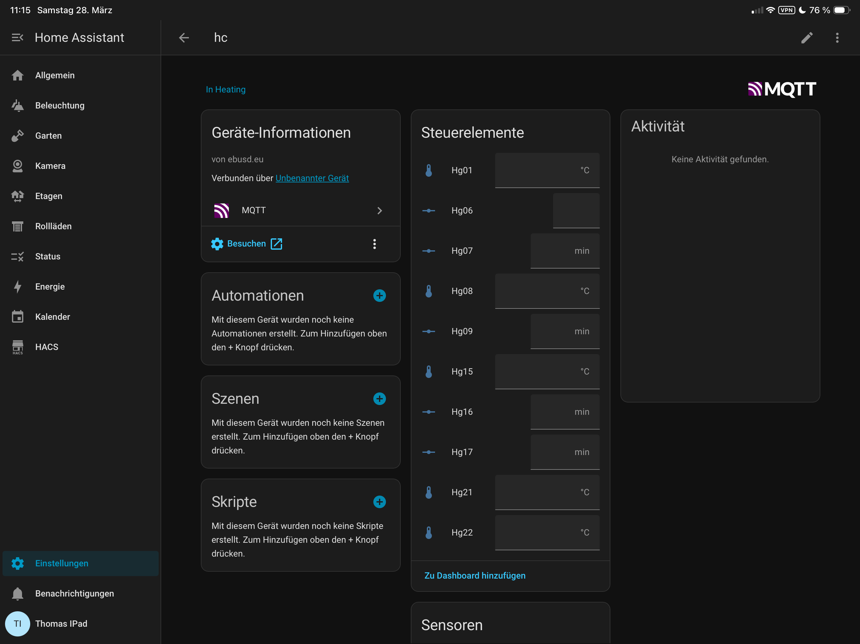

Unfortunately, I can currently only post one image, so here is a screenshot of the Home Assistant page.

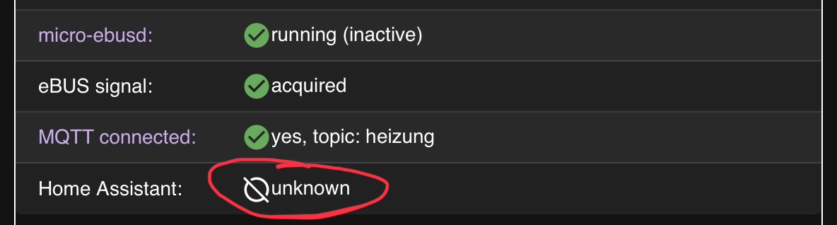

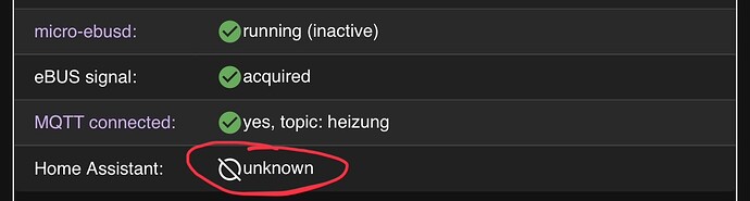

Thanks for the tip. I hadn’t thought of that, and I couldn’t find any information about it in other forums.
Now I’m one step closer since the connection is established.
Unfortunately, I’m still not receiving any data from the heating system.
Unfortunately, this information from the log is not being received by HA via MQTT.

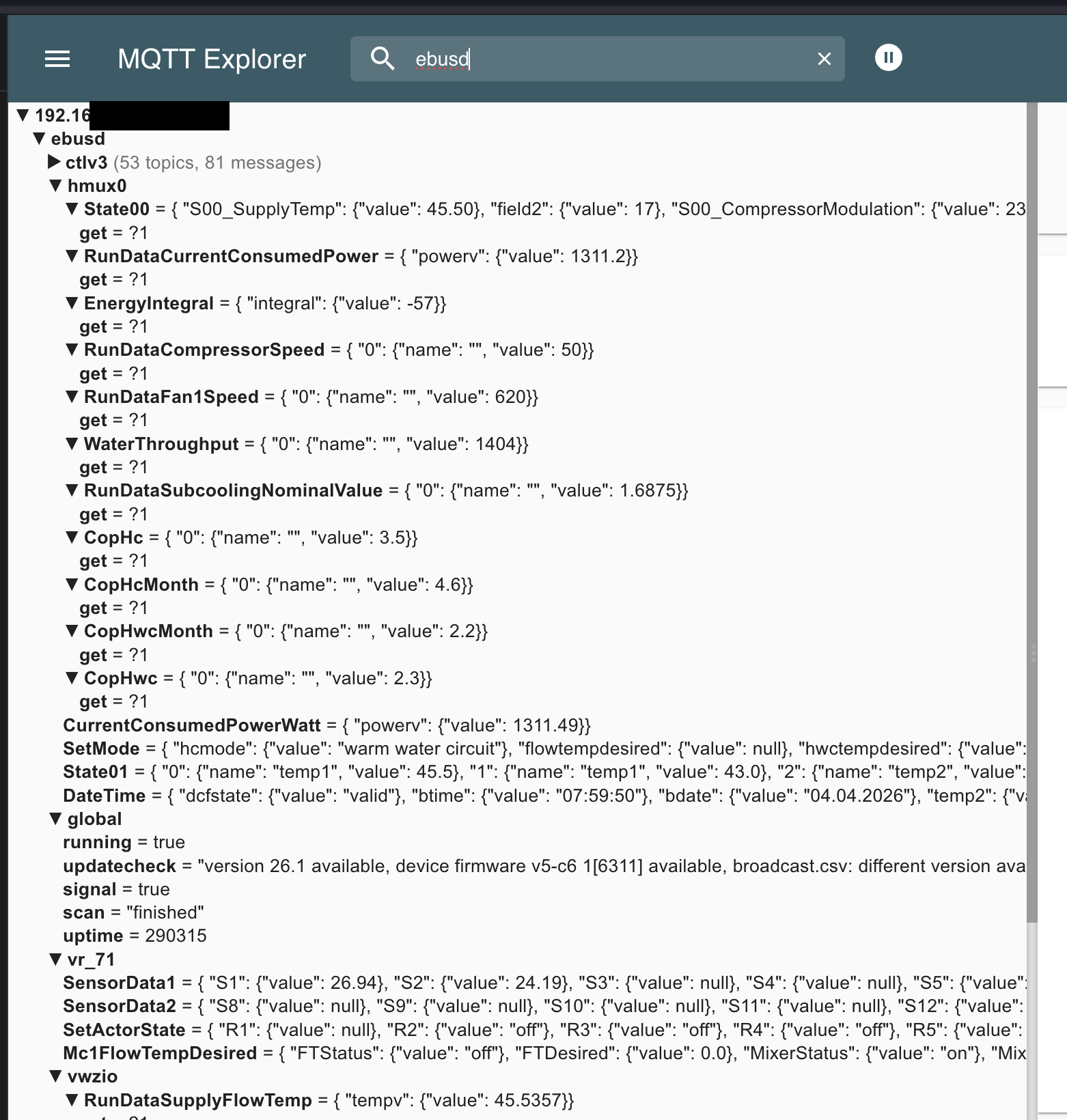

However, I can see this information in the MQTT Explorer.

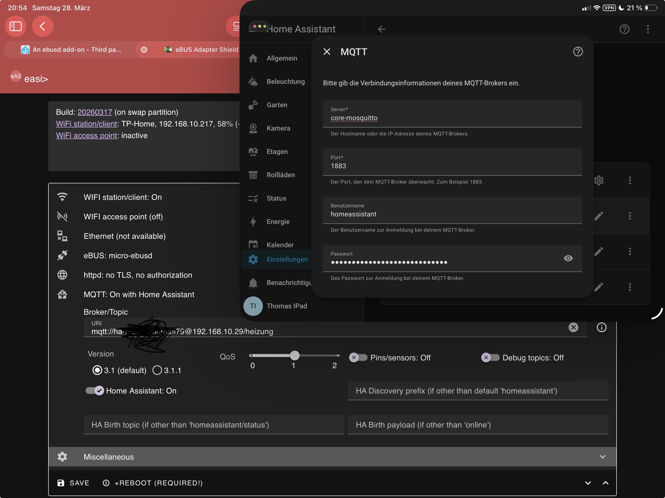

This is my first experience with ebusd and MQTT.
Is this correct, or should it say something else?
No that’s not correct.
You need to tell uebus the address and username/password of the MQTT server you are running, which needs to be accessible by the MQTT integration.
This is what the Home Assistant configuration looks like. The MQTT connection works without any problems.

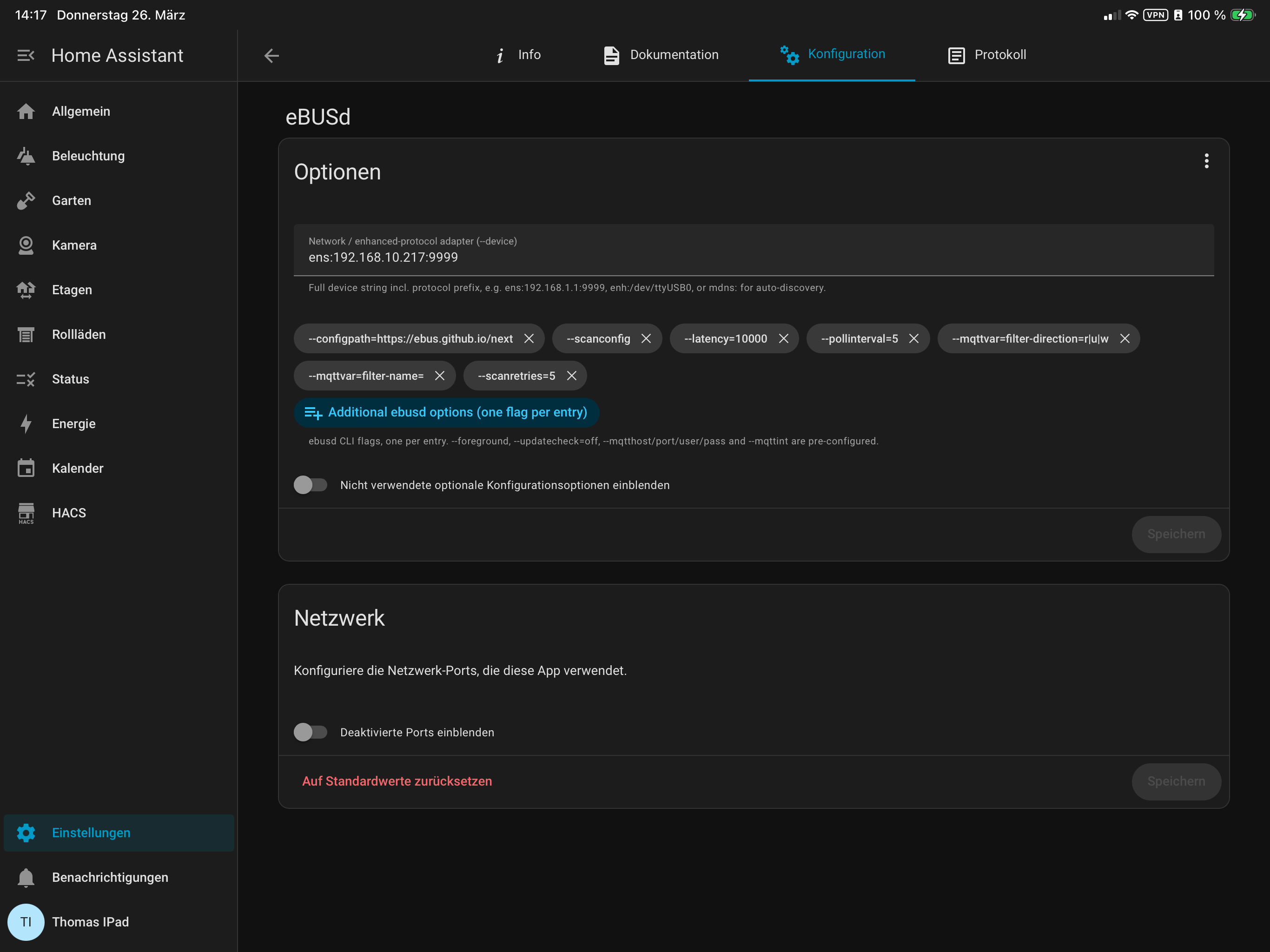

My ebusd configuration:

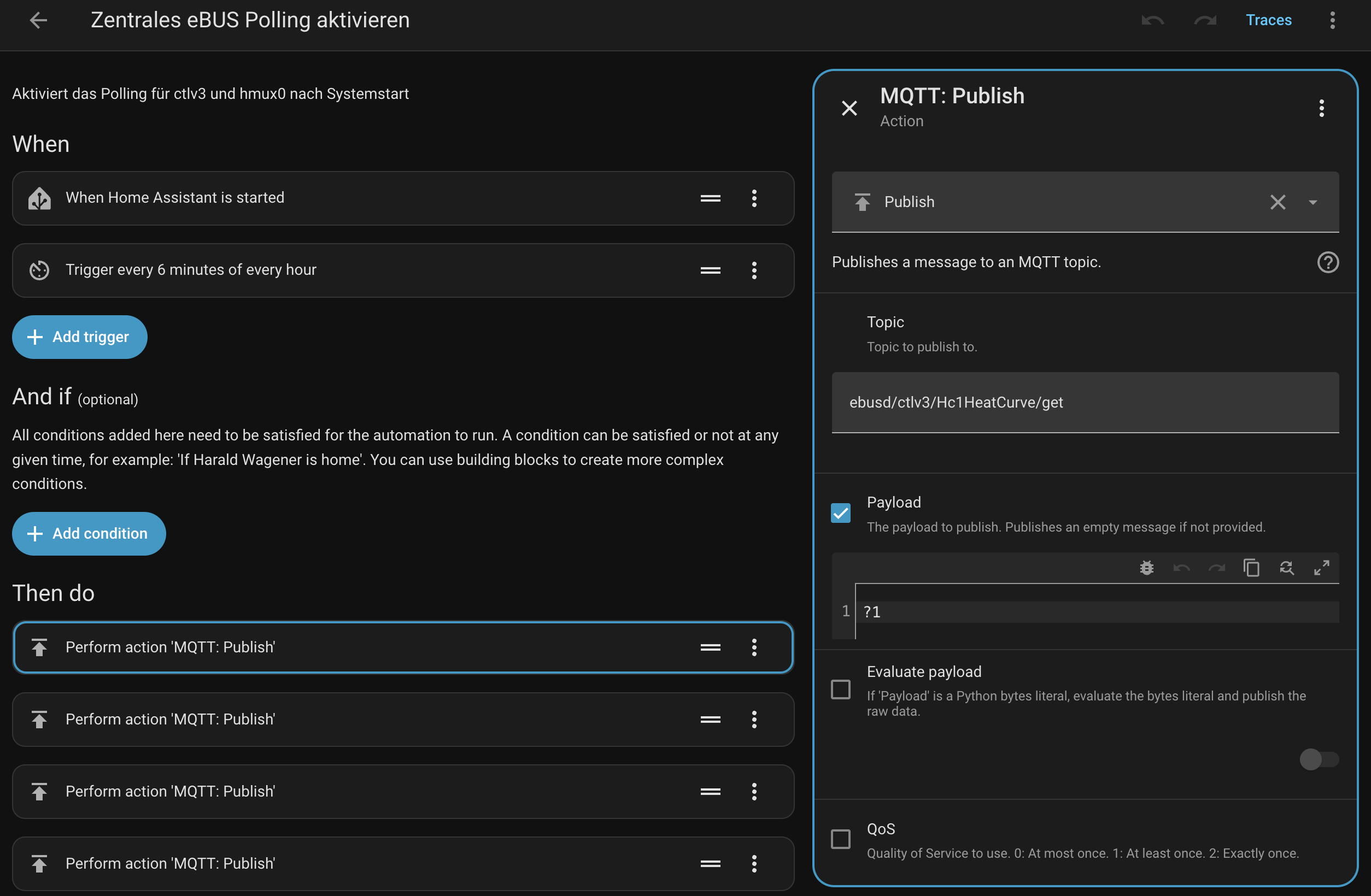

You can set priority by polling an entity with ebusd/$circuit/$entity/get and content ?1 via MQTT. I have an automation that does this for all known ebusd entities at home assistant startup and once per hour. (
Can you specify a bit more? I am new to that topic. And also can you share your automation?

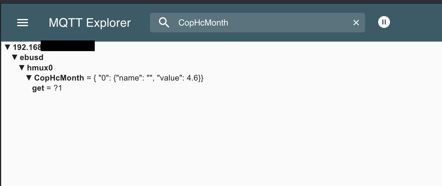

OK, so if you check your MQTT server, i.e. with the MQTTExplorer App, or any other way, you will see an ebusd topic, with a number of entries and values.
A freshly started ebus instance may not update (some) values frequently. But ebus knows priorities for certain values, and you can set them in various ways. For thes examples, assume I want to get the CopHcMonth value updated more regular (chosen because it usually is not reported very often)
  1. on the commandline:
ebusctl read -p 1 -f -c hmux0 CopHcMonth
This means that I read the value, while setting Priority to 1 (-p 1), getting fresh values (-f), from the circuit hmux0. After that, this value will be sent more frequently due to the priority setting.
But I can do this via an MQTT message I send to the MQTT server as well. On the MQTT side, the topic is ebusd///get (equivalent to read), with the message ?1 (equivalent to -p 1).
I should immediately get a value back:
Side note: Some values seem to get filtered by the default hass-mqtt.config of ebusd, and instead of tweaking that, I pull the values as MQTT sensors. An example from my configuration.yaml:

the good news is that I can query those as well with the get and ?1 method to get them to update speedily. And you can build your own climate and water heater entities this way that make use of multiple entities.

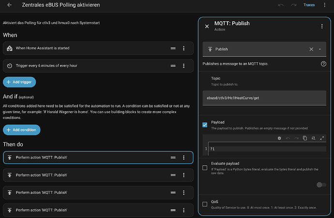

Back to automations. It’s tedious to do that for more than one time for more than one value after ebusd restarts. So, let’s automate this.
The simple version: For every value you are interested, add an MQTT publish action. Run this whenever HomeAssistant starts, and every hour.
But this is kinda annoying if you have many entries you want updated, so there is another way: Find all ebus controlled sensors, build the MQTT query for that and run them in a loop. So that’s automatable as well. Unfortunately, in preparing this post I found my full automation to be somewhat broken so I need to revisit and fix it up. But that’ll take some time.

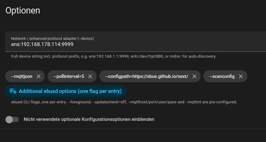

I recently did the uodate to ebusd 26.x and the changes seem to have broken my system. I am running HA on a RP4 with an ebus adaptor v5 and ebusd as an app.
The website of the ebus adaptor v5 shows the signal as acquired.
However, I don’t get any messages through to ebusd. Ebusctl info shows the signal as not present. How can I debug that further?
No changes were done around the serial interface but I am not certain that there wasn’t an inadvertant change due to some other update.
@miho8 Can you share your App config yaml?
A common mistake is not entering the ens prefix for the device.
Your screenshot of the adapter lists ens:/dev/tty… as the device string but your ebusctl info reads /dev/tty… (missing the ens protocol)
