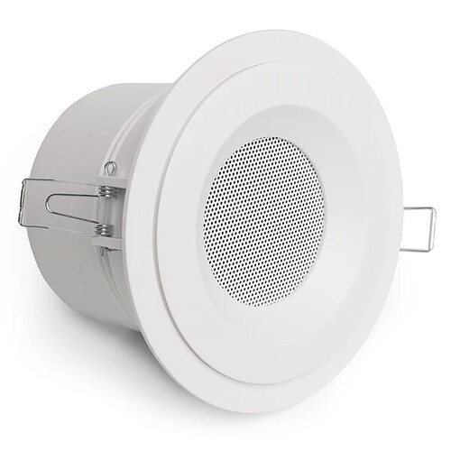

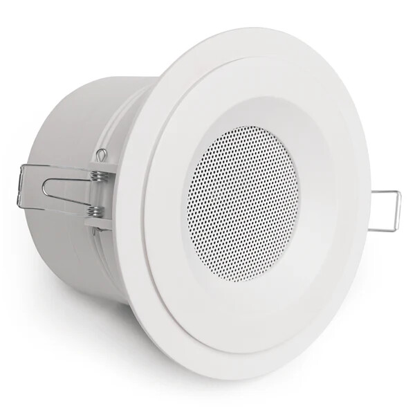

ideally the ultimate voice assistant would look like this:

Ive been researching the matter on spare time, to create just that. A voice assistant that is embedded like a reccessed ceiling speaker with great audio capture & a good enough frequency response to stream music too but theres other hurdles as a voice assistant cant do all of these things on its own without a server to run airplay, so this isnt the end of the for me but a clear obstacle in my way to my ultimate voice assistant experience. I have design a custom pcb that can do all of these things as well as power a full sized driver (at least a 4inch speaker, car sized speakers) then when all of that is done head over to cad and design a mount/enclosure to hang it int he ceiling.
