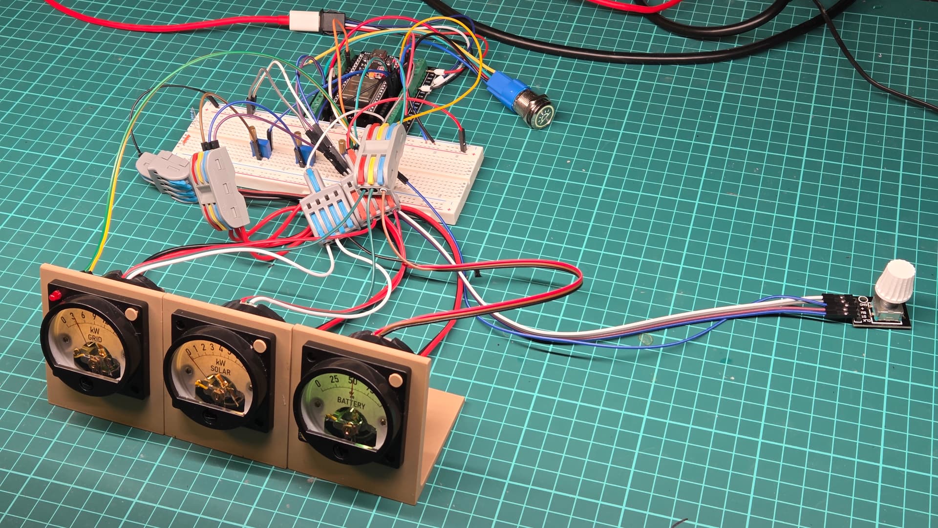

ESPHome was a clear choice for driving the electronics - I first started looking for PWM controlled gauges until I realized I can simply get a 20mA ammeter and use a PWM output of an ESP32 to control its position (using a 0-3V voltmeter would most likely work just fine). Each gauge is connected to a separate pin with a 0-200 Ohm pot in series to allow for fine base calibration (there a a couple more ways down the road to adjust each dial). This way you can create a fan component in ESPHome connected to ledc output and control its speed which in turn controls the PWM of the output which in turn adjusts the current and that sets the position of the dial.

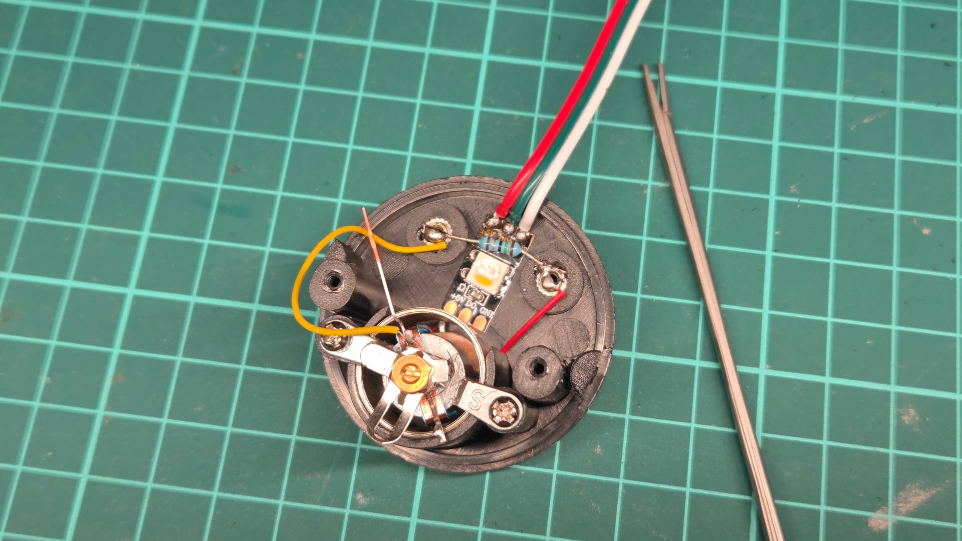

- 3x 20mA ammeter dials - with some adjustments
- I’ve replaced the dial backplate with a 3dprinted copy made from a thin sheet of white PLA so that it stays translucent
- SK6812 RGBWW LED - implanted into the dials as their backlight
- Custom dial made (with a lot of trial and error) using GaugeMasterPro
- 3x 200Ohm pots - I think I’ve ended up at about 80 Ohm on them…
- a momentary backlit switch - used as a master switch and power indicator
- a rotary encoder with a switch - used to adjust the global brightness (or global calibration factor) and to start/stop the calibration procedure itself
- 3 red LEDs - used as additional indicators for each dial
- USB passthrough - I intentionally went with a passthrough (and not just power) so that I can connect to the ESP32 from the outside if I ever need to flash it via serial… because loosening 4 screws is too hard…

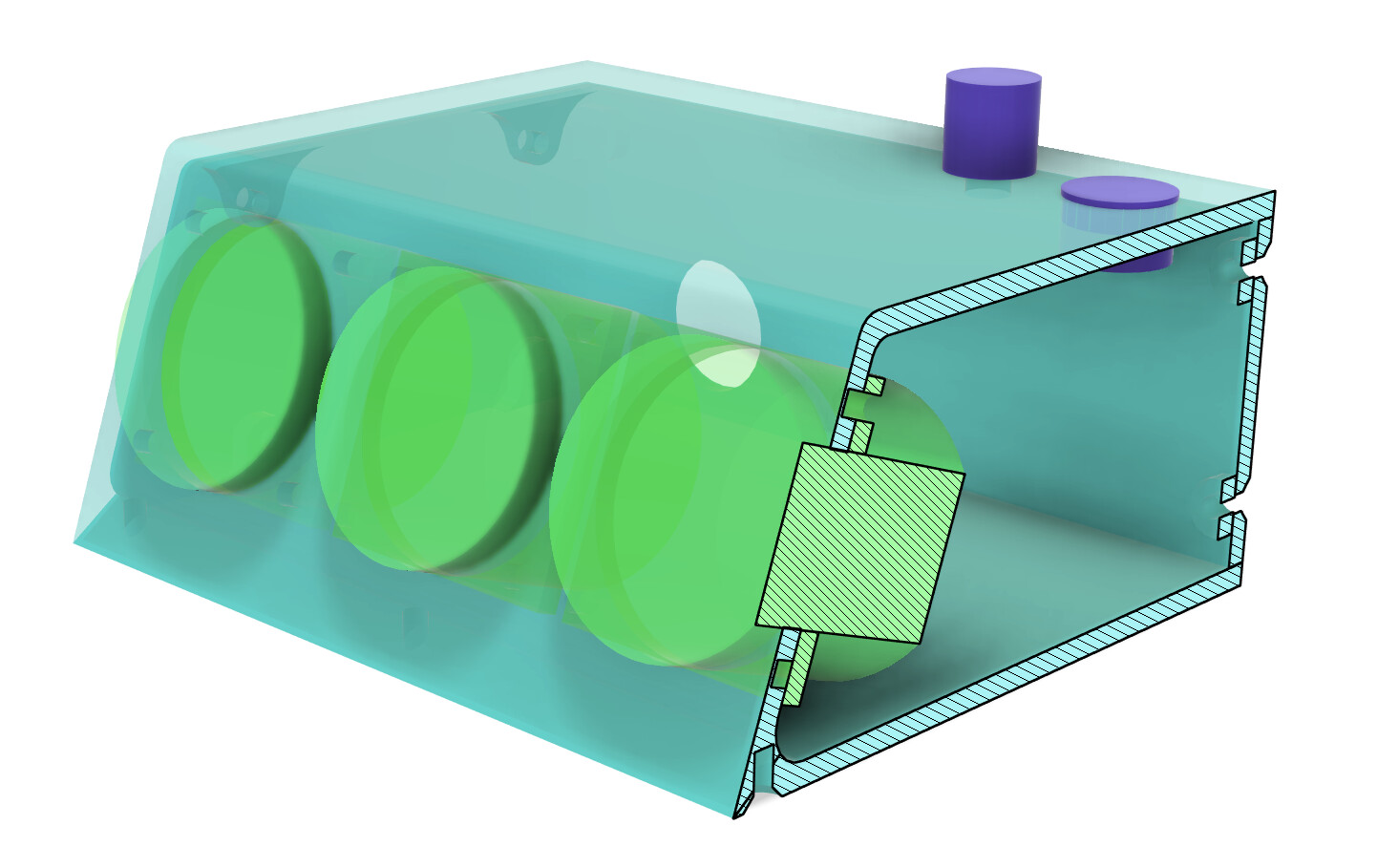

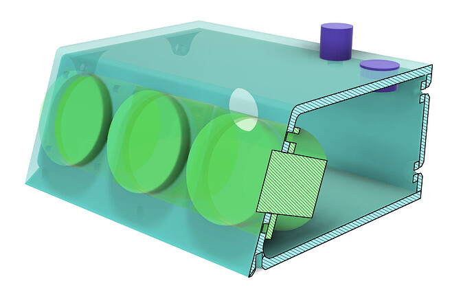

CADed up in Fusion 360 with my VERY rudimentary skills. I’m willing to share the STL but not the CAD file, anyone who knows their way around Fusion would (rightfully) lynch me. I’ve printed it in “wood” filament on a Prusa Mk3 and as you can probably tell from the photos, there probably isn’t a single piece that I didn’t print at least in 3 versions before I landed on the final design. One aspect I find pretty neat is that the indicator LEDs are hidden behind 0.5mm of PLA, making them invisible when off but still very clear when on.

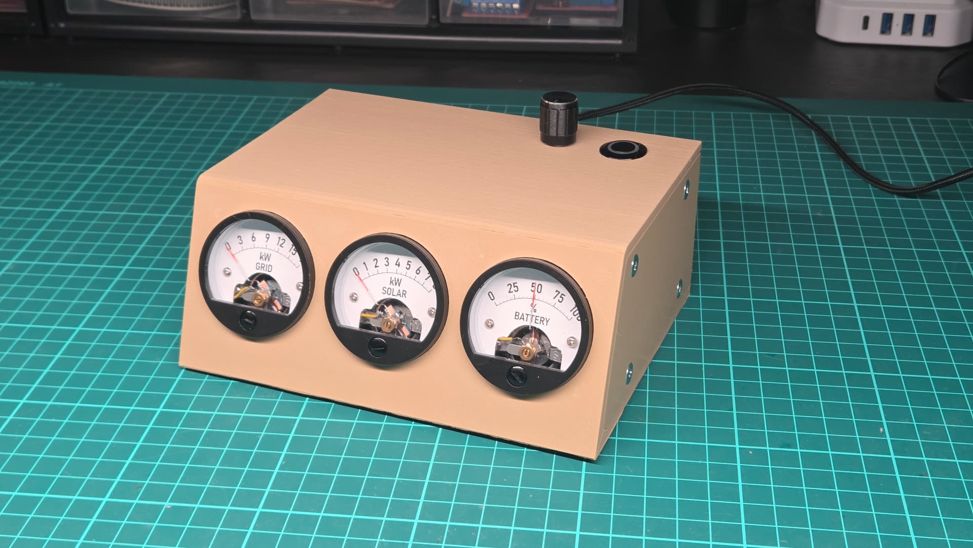

I have the dials configured to show the power imported from the grid, current solar generation and house battery (all updated every 10s by reading data from my solar inverter), alternatively the battery gauge can show my car’s battery SoC plus an indicator for charging. With “0 when off” enabled, I can easily see if I’m currently drawing any power from the grid or if solar is generating any power just by the state of the backlight…
I’m pretty happy with how the whole thing turned out, the dials are “delightfully old school” and make the most amazing clunk when they hit zero… for some reason I absolutely love that about them ![]()
