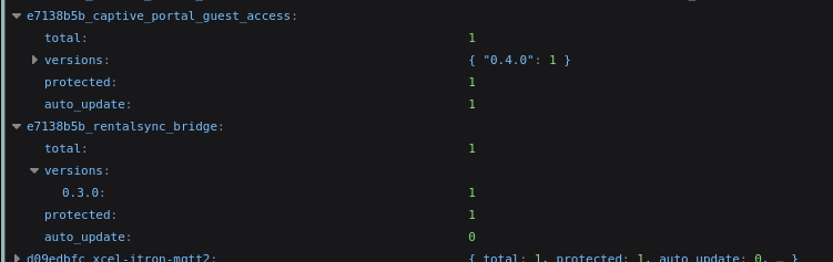

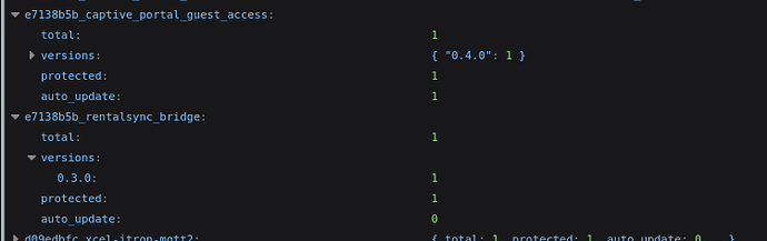

Addons/Apps are found in the Addons Analytics
Rental Control integration is in the integrations analytic:
Keep in mind that Analytics are opt-in, and only represent about 1/3 of the estimated instances out there...
