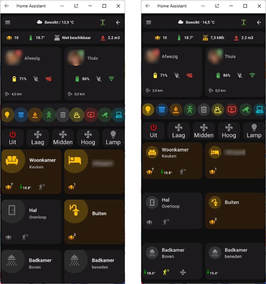

After a major Home Assistant update (please don’t ask me which one exactly), the layout of the dashboard started acting up. The strange part is, it doesn’t always happen, but it does happen often. When I open HA, I suddenly see large empty spaces between cards, and some buttons behave weirdly. If I restart HA a few times, things usually go back to normal. But the next time I open it, the issue returns.
On the left you’ll see the correct version of the dashboard, and on the right the “broken” one.
When I press the “lamp” icon on the broken dashboard, I would normally be redirected to the lights card. That no longer works in this situation!
Instead, what happens now is that the remaining icons turn grey, as if I’m toggling them on and off. Very strange behavior!
