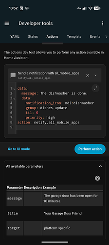

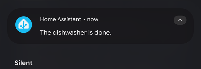

Just upgraded to a Pixel 10 today and noticed the notification icons aren’t working as expected. Wanted to see if anyone else has seen the same issue.
They’re correct in the notification bar:
But not when pulled down:
you should see the correct icon in the status bar, previously we saw this with samsung but they had a setting to turn it off. That does not seem to be the case now

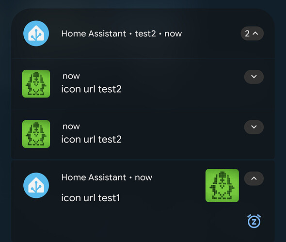

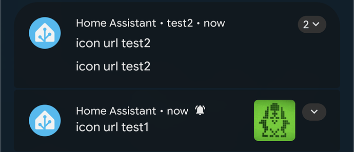

This isn’t a great workaround since you still need to separately set the notification_icon for the top notification bar and then you need to find a PNG of the icon and either store it in your HASS media or link to a web accessible version, but you can set an icon_url that will then show up in the pulled down notification list. For single notifications, it shows up on the right in addition to the HASS icon on the left. For multiple grouped notifications it isn’t visible until you expand the list of notifications.
