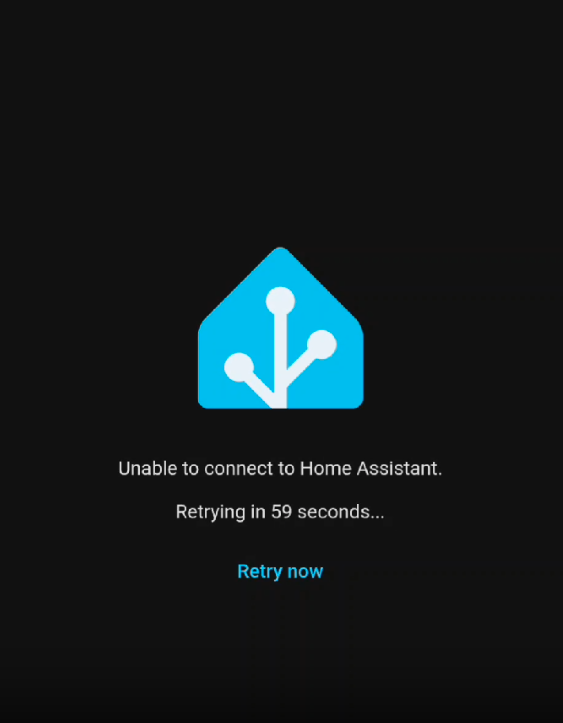

I’m trying to set up mTLS on my Android phone so that only devices with a valid client certificate can access my server.
My setup is basically:
Android phone (with .p12 file) → Caddy (reverse proxy + mTLS) → Home Assistant
The issue is that when I open the Home Assistant app on Android, I get “Unable to connect to Home Assistant.” I have to press “Retry now” twice before the app finally connects and loads my Home Assistant dashboard.

I’ve been experiencing this as well for a while, at least a year I think. My setup is almost completely different from yours other than the Android app and mTLS.
I have Cloudflare handling the mTLS in front of a cloudflared tunnel into my home network. I have to click retry several times before it decides to work sometimes.
Given the difference in our setups, I think that’s a pretty good indicator that the problem lies either with the HA app itself, or with Android.
FYI, I just have to accept the certificate every time I open the browser, but it works immediately after that. I don’t have to click the “Retry” button.
So, I understand that the issue is coming from the app itself.
I also don’t see any errors in the Caddy logs.
Any idea what I can do to fix this?
I did a cursory search and didn’t see it as an issue on Github, so creating that would be a good idea after verifying no one has raised the issue already.
If you’re inclined to, trying to reproduce the behavior while monitoring the Android logs (logcat) might be a good first step for debugging and determining what the root cause is. From there one could theoretically make the fix and then issue a pull request!
FYI, Installing version 2026.8.4 apk resolved the issue. https://github.com/home-assistant/android/pull/738
