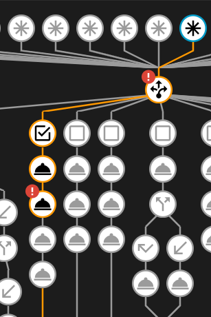

Today though, notifications seem to have given up completely. My automations are firing, but stop when the notification fails to send, like this:
It’s causing all sorts of things to fail!
If I manually ‘run action’ from within an automation, I see this:
and this:
