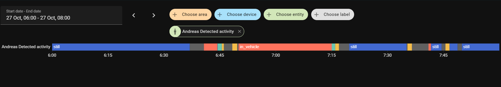

Bluetooth is an option, but so is the detected activity.
It’s not perfect, it usually does not recognize driving for the first minute or so but at the end of the drive it is usually correct.
