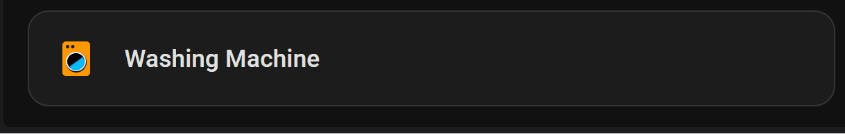

I’ll have to look at all your code closer when I have time. For now, here is a quick stab at updating the code for the washing machine animation.
type: custom:mushroom-template-card
entity: input_boolean.test
icon: mdi:washing-machine
color: orange
features_position: bottom
card_mod:
  style:
    ha-tile-icon$: |
      .container:after {
       content: '';
       position: absolute;
       width: 28%;
       height: 27%;
       border-radius: 100%;
       border: 1px solid white;
       background:black;
       top: 14.2px;
      .container:before {
       content: '';
        z-index: 1;
       position: absolute;
       width: 26.1% !important;
       height: 26% !important;
       opacity: 100%  !important;
       top: 43.1% !important;
       left: 36.7% !important;
       background: deepskyblue !important;
       animation:spin 2s linear infinite;
       clip-path: inset(0 0 50% 0 round 50% 50% 0 0);
       @keyframes spin {
       0% {transform: rotate(0deg);}
       100% {transform:rotate(360deg);}
example

Frist attempt:
entity: input_boolean.geschirrspueler_laeuft
icon: mdi:dishwasher
color: orange
primary: >-
  {% set power = states('sensor.steckdose_geschirrspuler_power') | float(0) %}
  {% if power == 0 %}
     aus
  {% elif is_state('input_boolean.geschirrspueler_laeuft', 'on') %}
     lÀuft
  {% else %}
     fertig/bereit
  {% endif %}
secondary: >-
  {% if power == 0 %} {% elif is_state('input_boolean.geschirrspueler_laeuft',
  'on') %} {{ power | round(0) }} W {% else %} {{
  states('input_number.dauer_letzte_geschirrreinigung') | int }}min {% endif %}
badge_icon: |-
  {% if power == 0 %}
    mdi:power-off
    mdi:progress-clock
  {% else %}
    mdi:check-circle
  {% endif %}
badge_color: |
  {% if power == 0 %}
    grey
    blue
  {% else %}
    green
  {% endif %}
card_mod:
  style:
    ha-tile-icon$: |
      .container:after {
       content: '';
       position: absolute;
       width: 28%;
       height: 27%;
       background:black;
       top: 14.2px;
      .container:before {
       content: '';
        z-index: 1;
       position: absolute;
       @keyframes spin {
I struggling a little bit with the transparent background of the card. Your code is “only” for washing machines, isn’t it? Nevertheless you did a great job. I will try to implement the code in my card. If you have some hint, please let me know .:wink:
Thanks a lot and have a nice weekend.
Ronny
P.S. The animation doesn’t stops. Did I something wrong?

      float(0) %}
      {% set running = is_state('input_boolean.waschmaschine_lauft', 'on') %}
      {% set active = running and power > 0 %}
      {% set ready = (not running) and power > 0 %}
      .shape {
        {% if active %}
          --icon-color: rgb(var(--rgb-blue));
          --wash-glow: ultra-wash-glow 1.8s ease-in-out infinite;
          --wash-drum: spin-laundry 0.6s linear infinite;
          animation: ultra-wash-thump 1.8s ease-in-out infinite;
          opacity: 1;
        {% elif ready %}
          --icon-color: rgb(var(--rgb-green));
          --wash-glow: none;
          --wash-drum: none;
          animation: none;
          opacity: 1;
        {% else %}
          --icon-color: rgb(var(--rgb-disabled));
          --wash-glow: none;
          --wash-drum: none;
          animation: none;
          opacity: 0.6;
        {% endif %}
        isolation: isolate;
        position: relative;
      .shape::after {
        content: "";
        position: absolute;
        top: 58%;
        left: 50%;
        width: 24px;
        height: 24px;
        border-radius: 50%;
        background: conic-gradient(
          transparent,
          var(--icon-color),
          transparent
        transform: translate(-50%, -50%);
        animation: var(--wash-drum);
        {% if not active %}
          display: none;
        {% endif %}
      .shape::before {
        content: "";
        position: absolute;
        inset: -4px;
        border-radius: 50%;
        animation: var(--wash-glow);
      @keyframes spin-laundry {
        0%   { transform: translate(-50%, -50%) rotate(0deg); }
        100% { transform: translate(-50%, -50%) rotate(360deg); }
      @keyframes ultra-wash-glow {
        0% {
          box-shadow:
            0 0 10px 3px rgba(var(--rgb-blue), 0.6),
            0 0 20px 8px rgba(var(--rgb-blue), 0.3);
        50% {
          box-shadow:
            0 0 18px 6px rgba(var(--rgb-blue), 0.9),
            0 0 32px 12px rgba(var(--rgb-blue), 0.4);
        100% {
          box-shadow:
      ha-card {
        background: transparent;
        border-color: transparent;
        border-radius: 18px;
        color: #ffffff;
works not
entity: input_boolean.waschmaschine_lauft
primary: >-
  {% set power = states('sensor.steckdose_waschmaschine_energy_power') |
  float(0) %} {% if power == 0 %}
     aus
  {% elif is_state('input_boolean.waschmaschine_lauft', 'on') %}
     lÀuft
  {% else %}
     fertig/bereit
  {% endif %}
secondary: >-
  float(0) %} {% if power == 0 %} {% elif
  is_state('input_boolean.waschmaschine_lauft', 'on') %} {{ power | round(0) }}
  W {% else %} {{ states('input_number.dauer_letzter_waschgang') | int }}min {%
  endif %}
badge_icon: >-
    mdi:power-off
    mdi:progress-clock
  {% else %}
    mdi:check-circle
  {% endif %}
badge_color: >
    grey
    blue
  {% else %}
    green
  {% endif %}
multiline_secondary: false
visibility:
  - condition: screen
    media_query: "(min-width: 0px)"
grid_options:
  columns: 5
  rows: 1
card_mod:
  style:
    mushroom-shape-icon$: |
      float(0) %}
      .shape {
        {% if active %}
          opacity: 1;
        {% elif ready %}
          --wash-glow: none;
          --wash-drum: none;
          animation: none;
          opacity: 1;
        {% else %}
          --wash-glow: none;
          --wash-drum: none;
          animation: none;
          opacity: 0.6;
        {% endif %}
        isolation: isolate;
        position: relative;
      .shape::after {
        content: "";
        position: absolute;
        top: 58%;
        left: 50%;
        width: 24px;
        height: 24px;
        border-radius: 50%;
          transparent,
          var(--icon-color),
          transparent
        {% if not active %}
          display: none;
        {% endif %}
      .shape::before {
        content: "";
        position: absolute;
        inset: -4px;
        border-radius: 50%;
        0% {
          box-shadow:
        50% {
          box-shadow:
        100% {
          box-shadow:
      ha-card {
        color: #ffffff;
Hello community members.
I have now made same progress :wink:.
primary: >-
  {% if power == 0 %}
     aus
     lÀuft
  {% else %}
     bereit
  {% endif %}
secondary: >-
  states('sensor.steckdose_geschirrspuler_power') | int }}min {% endif %}
badge_icon: >-
  {% if power == 0 %}
    mdi:power-off
    mdi:progress-clock
  {% else %}
    mdi:check-circle
  {% endif %}
badge_color: >
  {% if power == 0 %}
    grey
    blue
  {% else %}
    green
  {% endif %}
visibility:
  - condition: screen
grid_options:
  columns: 5
  rows: 1
card_mod:
  style: |
    ha-state-icon {
      {% set running = is_state('input_boolean.geschirrspueler_laeuft', 'on') %}
      {% if running and power > 0 %}
        /* WEISS: LĂ€uft */
        filter: brightness(0) invert(1) !important;
        animation: ultra-wash-thump 1.8s ease-in-out infinite, ultra-wash-glow-white 1.8s ease-in-out infinite;
        /* Schwarzer Ring */
        border: 4px solid black !important;
        border-radius: 50%;
        padding: 1px;
      {% elif (not running) and power > 0 %}
        /* GRÜN: Fertig / Bereit */
        filter: invert(48%) sepia(79%) saturate(2476%) hue-rotate(86deg) brightness(118%) contrast(119%) !important;
        animation: ultra-wash-glow-green 2s ease-in-out infinite;
        border: 3px solid black !important;
        border-radius: 50%;
        padding: 1px;
        background: transparent !important;
      {% else %}
        /* GRAU: Aus */
        filter: none !important;
        animation: none !important;
        background: none !important;
      {% endif %}
      position: relative;
    ha-state-icon::after {
      {% if is_state('input_boolean.geschirrspueler_laeuft', 'on') and power > 0 %}
        content: "";
        position: absolute;
        top: 50%;
        left: 50%;
        width: 24px;
        height: 24px;
        border-radius: 50%;
        /* Weißer Schimmer fĂŒr die Trommel */
        background: conic-gradient(transparent 0deg, rgba(255, 255, 255, 0.8) 180deg, transparent 360deg);
        animation: spin-laundry 1.0s linear infinite;
        display: block;
        opacity: 1.2;
        /* Neutralisiert eventuelle Farbverschiebungen durch den Filter */
      {% else %}
        display: none;
      {% endif %}
    /* THE REQUESTED ULTRA GLOW (Double Shadow Layer) */
      0% {
        box-shadow:
          0 0 10px 3px rgba(var(--rgb-white), 0.6),
          0 0 20px 8px rgba(var(--rgb-white), 0.3);
      50% {
        box-shadow:
          0 0 18px 6px rgba(var(--rgb-white), 0.9),
          0 0 32px 12px rgba(var(--rgb-white), 0.4);
      100% {
        box-shadow:
    @keyframes ultra-wash-thump {
      0%   { transform: scale(0.85); }
      50%  { transform: scale(0.9); }
      100% { transform: scale(0.85); }
    ha-card {
      border: none;
It look good for me. Nevertheless I have a further question. Is it possible to change the grey circle of icon to transperant or another color in my code? At the moment the circle is filled grey. Is that a requirement from Mushroom Card?
Thanks for help and have a nice weekend and please stay healthy.
Update: I can answer by myself. > change Tap action on icon to none > no grey circle is shown anymore.
