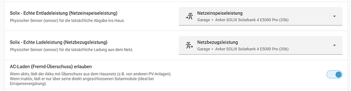

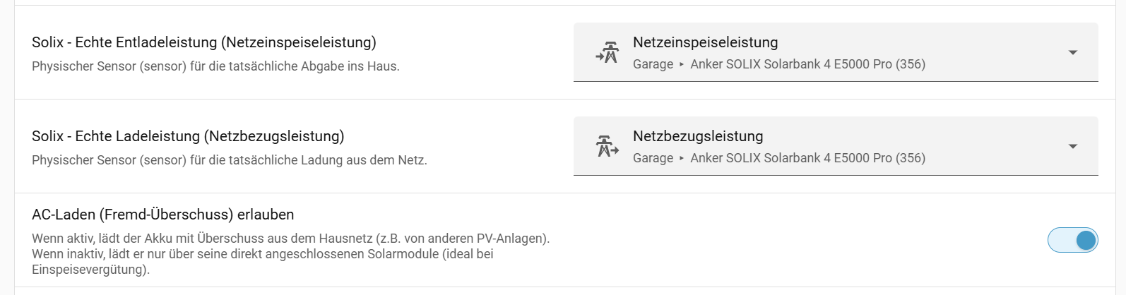

Update: Added AC Charging Toggle & Connection Drop Failsafe!
I’ve just updated the blueprint with two major improvements based on testing and user feedback:
1. Optional AC Charging (Grid Surplus Charging) You can now easily enable or disable AC charging via a simple toggle.
  • Enabled (default): The battery charges using excess power from your house grid (e.g., from other PV inverters).
  • Disabled: The battery will only charge via its directly connected solar panels. Perfect for users with a feed-in tariff (FIT) who prefer to sell their house surplus to the grid.
2. Real-Power-Check (Connection Drop Failsafe) We discovered a critical edge case: If the Solix loses its Wi-Fi connection while discharging (e.g., at 150W during the night), it physically keeps discharging. When Home Assistant reconnects, the integration sometimes falsely resets the target slider to 0W. Because HA thinks the slider is already at 0W, it won’t send a stop command, potentially draining your battery below your min_soc.
  • The Fix: I added two new inputs for the actual physical charge/discharge power sensors. The script now cross-references the real hardware state. If the hardware is physically outputting power when it shouldn’t, HA forces a hard 0W reset command to stop it.
:counterclockwise_arrows_button: How to update: Click the import link again and choose “Overwrite” in Home Assistant.
Important: After updating, please open your existing automation, scroll down, and assign the two new entities for the physical power sensors (Solix - Echte Entladeleistung & Solix - Echte Ladeleistung), then hit save!
