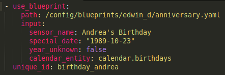

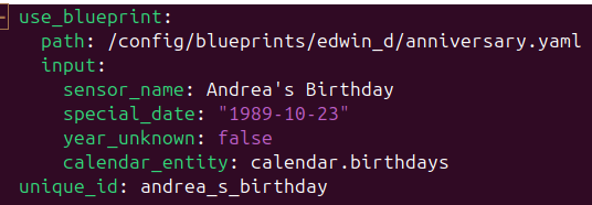

I have near 70 events for all of my entries. I’m not sure what you mean by using the settings of the entity to regenerate the unique id? Is this not ok?
You need to look at the entity id that the blueprint generated in the GUI. The name “Andrea’s Birthday” is what I use to guess it (a couple of variations on sensor.andrea_s_birthday). However, since your unique id is birthday_andrea, your entity id is probably something else. In the GUI is a button to recreate the entity id based on the name. That should change the entity id to what the blueprint expects.
I am not seeing an option to recreate the entity id based on the name for these sensors, but I was able to stop it from duplicating by making the name and unique id match exactly. Thanks again for your help on this. One thing I noticed though was in the calendar when I click on an entry and "edit event’ the bottom option is for “Repeat” and all entries are set to “No Repeat”. Does this need to be manually set for each entry once it’s created to repeat yearly?
It creates the next one the day after the anniversary. No repeat, mainly because if I can, I put the age in the title, and that is different every year.
