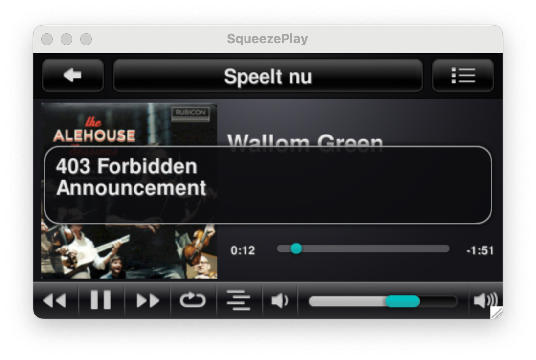

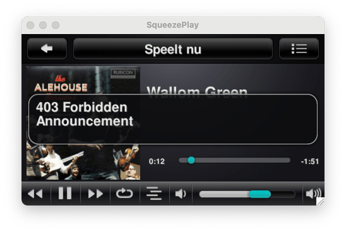

Recently, this stopped working: when I play an announcement, I see a “403” error message displayed on my Squeezebox Radio. This seems to suggest that the media to play is not accessible. However, when testing in the browser, the media does play, even if I use an Incognito window where I’m not logged in to Home Assistant. I’m not aware of any changes in my network setup.
Do other people have a similar experience? Does someone know how to resolve? Any hints would be highly appreciated!
Additional info: while investigating further, I was able to reproduce the issue with the SqueezePlay app on my MacBook. Using a web browser on that very same MacBook, I am able to play the media URL directly in the browser.
