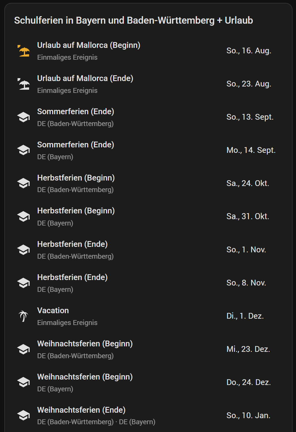

“Holiday” can mean very different things: public holidays, school holidays, or simply your own vacation.
:school: School Holidays
Import regional school breaks and choose whether to track the start, end, or every day of the break.
:globe_showing_europe_africa: Public Holidays
250+ countries and territories, regional holidays, 150+ languages, custom translations.
:beach_with_umbrella: Your Holidays
Add your own vacations as multi-day events and get that all-important countdown to your next trip. :smiling_face_with_sunglasses:

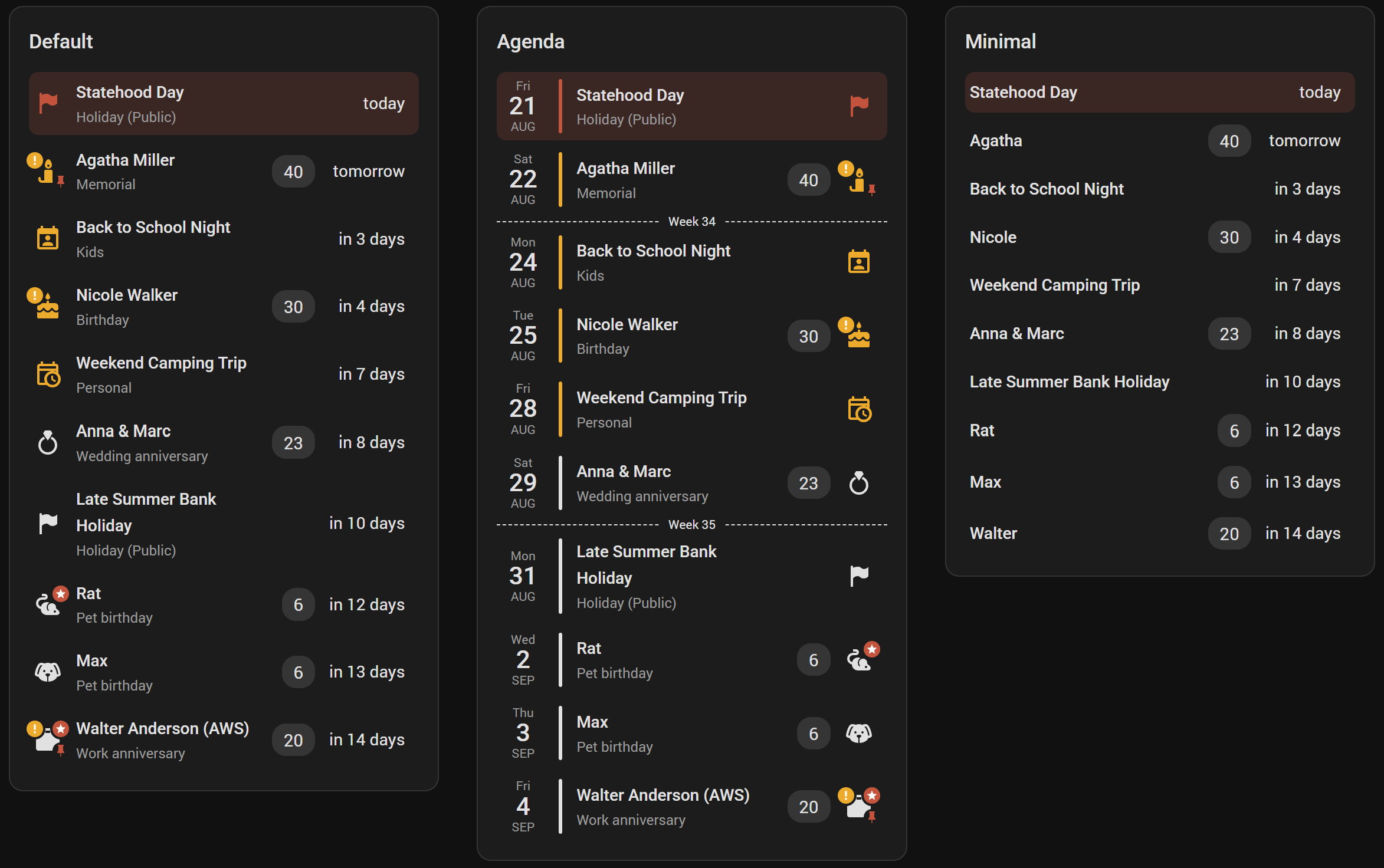

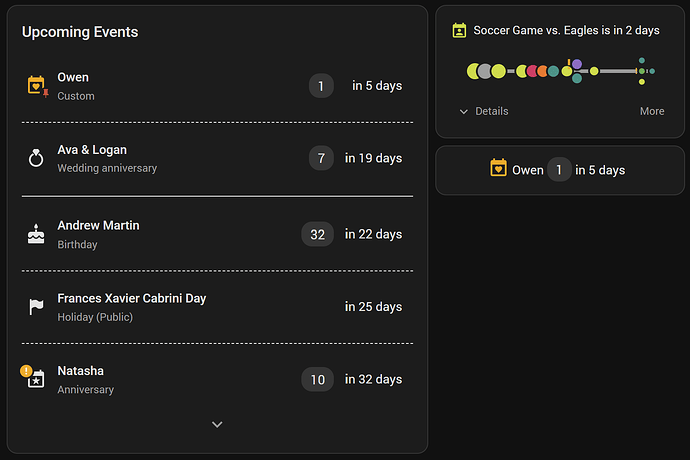

:artist_palette: Annuals v3.1.0 – Your Card, Your Layout
With Annuals v3.1.0, the main focus was clear: even more freedom to make the Annuals Card look exactly the way you want it. :rocket:
Instead of forcing you into a specific layout, you now have much more control over how your events are displayed.
:artist_palette: More flexibility
The individual elements of the card can be combined, arranged and styled more freely than before.
Date Block, Icon, Accent Bar, Name, Countdown, Timeline, Badges and more can all be configured individually.
Colors can also be assigned based on event type and status – for example birthdays, public holidays, school holidays, external calendars, or events happening today or coming up soon.
The result: the same Annuals Card can look completely different depending on how you configure it.
:sparkles: New Presets
To make getting started easier, v3.1.0 introduces three layout presets:
Default · Agenda · Minimal
One click gives you a complete starting layout, which you can then customize however you like.
The new Agenda layout was inspired by the excellent Calendar Card Pro and brings a compact, calendar-style look to Annuals.

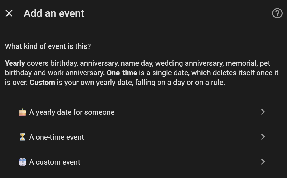

Pick what kind of event you are adding
Adding an event now starts by asking what kind it is — a yearly date for someone, a one-time event, or a custom one. Each kind then gets a form carrying only its own fields, instead of one long form with labels explaining which types they do not apply to.

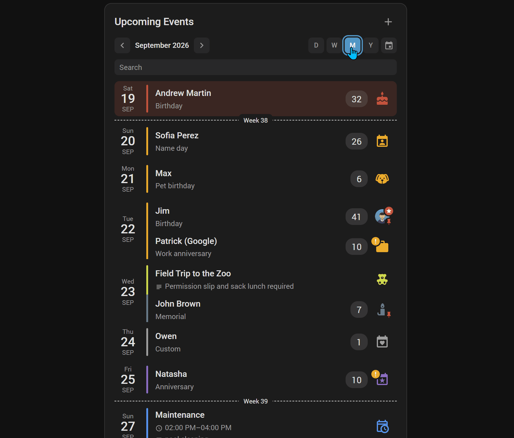

This release is about the card. So far it showed you what is coming; now you can move through it, search it, and keep it up to date without leaving the dashboard.
Page through it like a calendar — and search it
Calendar navigation and search in use
A bar under the card title turns the list into one period at a time — day, week, month or year — with two arrows, a date picker, a swipe on a phone, and a tap on the period itself as the way back to today. Under it, a search field that filters as you type: names, types, a holiday’s category, an embedded calendar entry’s location. Two letters are usually enough, and Escape clears it.
Both are a look, not a setting — nothing is written to the dashboard. So paging to next month on one phone leaves every other screen where it was, and a card nobody has touched follows the calendar across midnight.
Add, edit and delete from the card
A + beside the title opens the integration’s own Add an event steps in a dialog over the dashboard — the same fields, the same wording and the same language as under Settings → Devices & Services, because it is literally the same form. A pencil and a trash can float over the end of every row while the pointer is on it, or after a click on the row, which is how you reach them on a phone where nothing hovers.
Administrators only, since only they may add or change integration entries. All three are switchable, and each takes its own color, hover color, icon and size in the editor.

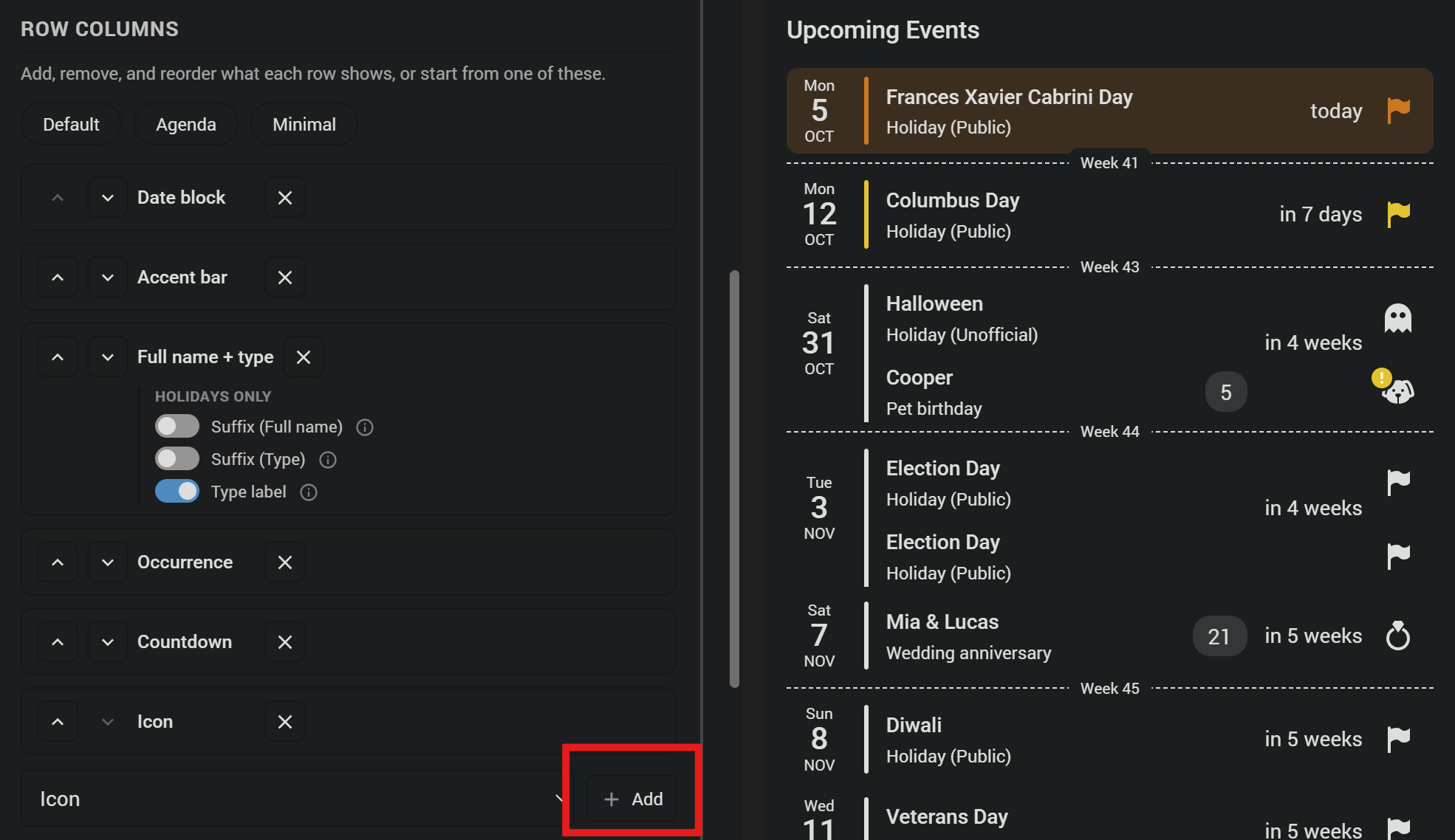

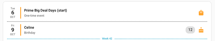

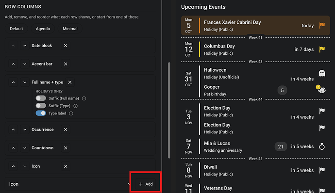

Thank you for this fantastic integration!

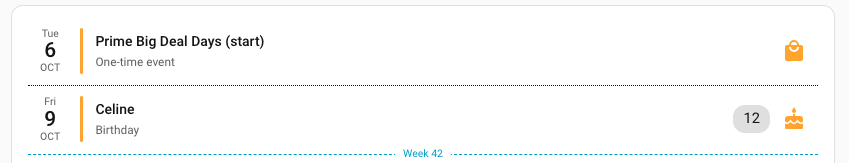

Currently, the List view shows the time remaining (e.g., “in 4 days”),
while the Agenda view shows the date (e.g., “Fri 9 October”).
Is it possible to display both the relative date and the exact date for each event in Agenda view?
Something like this?
Yes, you can setup the rows, how you prefer. Means, you can change the content of each rows after setting a preconfigured template under LAYOUT->LIST VIEW->ROW COLUMNS:
This would be the YAML in your case:
week_separators: true
week_separator_label: true
columns:
  - id: date_block
    type: date_block
  - id: accent_bar
    type: accent_bar
  - id: full_name_type
    type: full_name_type
  - id: badge
    type: badge
  - id: when
    type: when
  - id: icon
    type: icon
type: custom:annuals-card

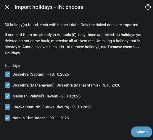

v3.4.0 released:

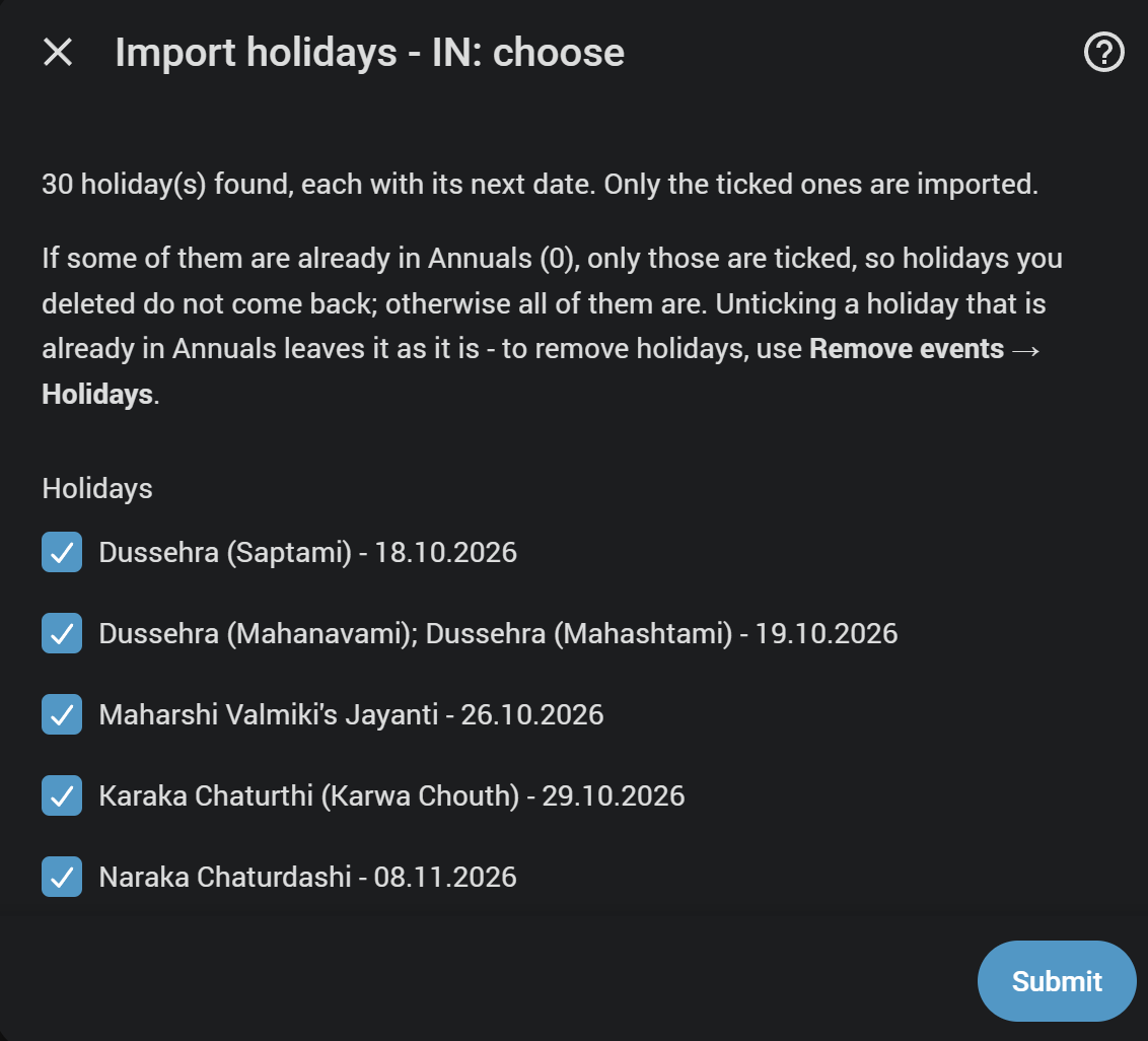

:check_box_with_check: Pick the holidays you want. The holiday import has a third step: every holiday your country, region and categories produce, each with its next date, in the order they come up - and a checkbox for each. Only the ticked ones become events. No more importing thirty holidays to keep three.

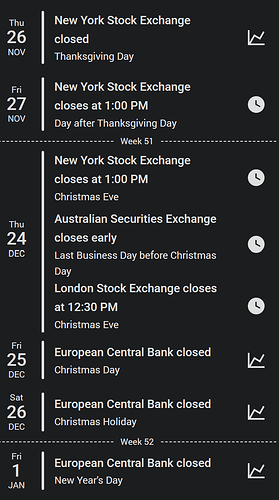

:chart_increasing: Stock exchange days. Import events → Stock exchanges brings in the days a stock exchange is closed, and the days it closes early, from 25 markets - New York, Nasdaq, London, Frankfurt, Zurich, Tokyo, Hong Kong, Sydney and more. They are not holidays, so they are an event type of their own, with their own calendar, card filter and colour - and they say what they are: New York Stock Exchange closes at 1:00 PM, for Day after Thanksgiving Day.
:world_map: A category without holidays where you asked says so. Some only exist below the country - Germany’s school holidays per state, India’s women-only holidays in Himachal Pradesh. Picked without the right region, the import used to report 0 queued; it now names the regions that have any.
:label: Every category has a name. Optional (women) was the one category of the holidays library that Annuals had no word for - checked against its full list, in all sixteen languages and in the reminder blueprint.
:open_book: Full release notes: CHANGELOG
:star: If Annuals is useful to you, a star on the repo is genuinely appreciated - it is how other people find it. Thank you!
