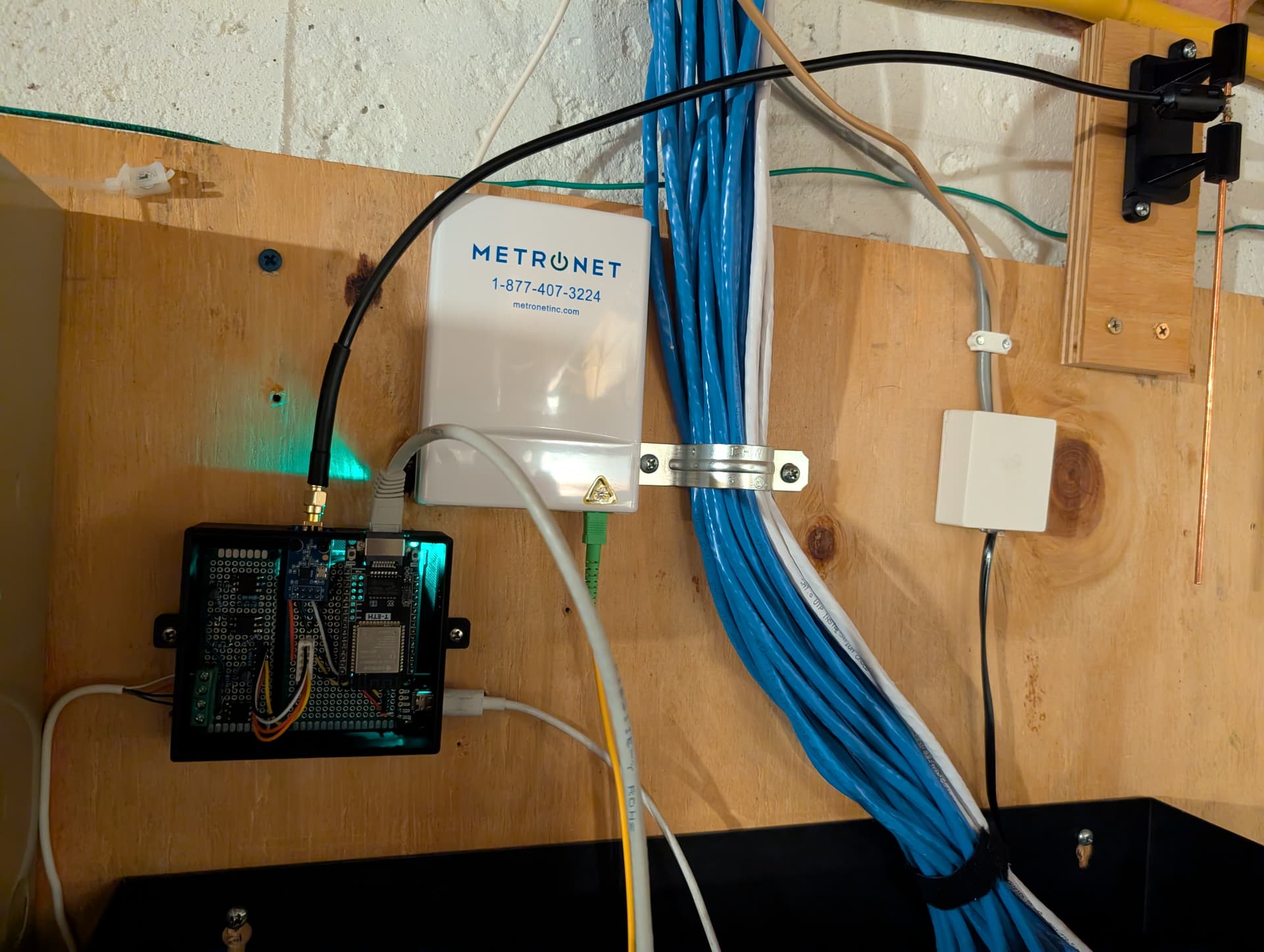

The RF implementation uses the CC1101 in asynchronous serial mode with GDO0 outputting the raw demodulated OOK signal, which the ESP32’s RMT peripheral captures and decodes via a software Manchester decoder. I also designed and built a simple custom half-wave dipole antenna tuned for 345 MHz, which has given excellent signal reception.

Here is my installation using a Lilygo T-Eth-Lite S3 and a cheap CC1101 from Amazon cobbled together on some perf board. The dipole antenna is visible on the right.
