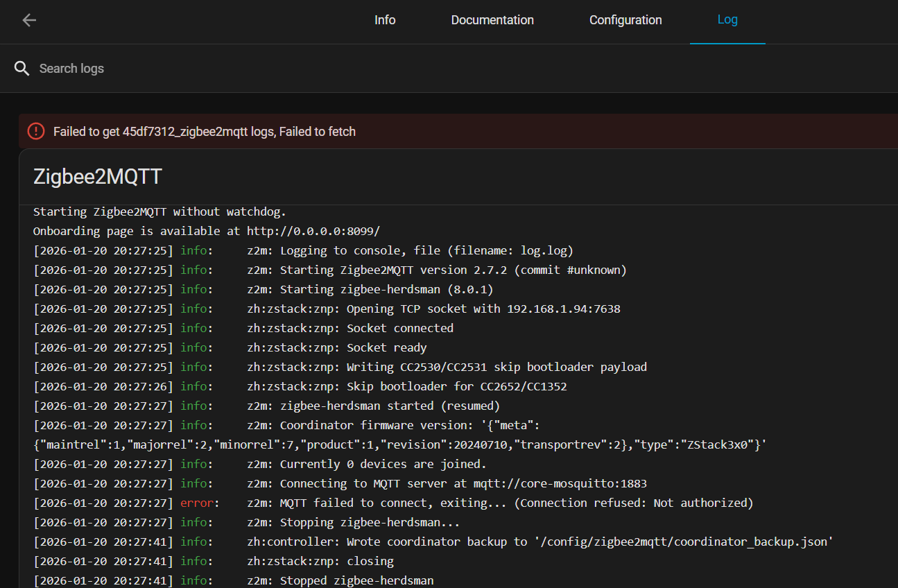

Setting up HA, using a SLLZB-MR1U as coordinator; running latest firmware. I’ve been viewing Youtubes and reading countless articles and think I’m making progress but I have the following error and have no idea where to go next:
Are your MQTT connection login and password correct?
Do you have the MQTT add-on installed? (Assumption HAOS there)
There are 3 component to using z2m in haos;
  • zigbee2mqtt addon itself, this communicates directly to the dongle and communicates to the mqtt broker
  • the mqtt broker addon, this sits between z2m and ha, and relays the messages/topics
  • the mqtt integration, this sits between ha and mqtt, and lets ha <> mqtt communicate
the error indicates that it can’t communicate with the mqtt broker, make sure it is installed and running
Thanks for the clear explanation of how this works! I had overlooked that I needed to add a login to the Mosquitto broker.
