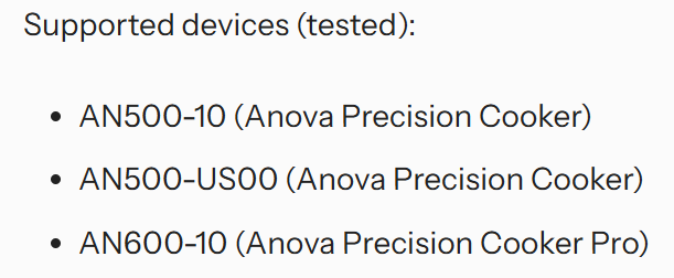

If your model number (ANxxx) does not match any of the 3 officially supported devices in the documentation, then what you are asking for is a feature request, not a bug.

If the documentation says that only these three devices are supported:
  • AN500-10 (Anova Precision Cooker)
  • AN500-US00 (Anova Precision Cooker)
  • AN600-10 (Anova Precision Cooker Pro)
and all other devices should be treated as feature requests, then the integration is no longer relevant in its current documented form.
