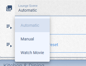

I use an input select to keep track of which scene is active.
This is then used in automation conditions that control the lights.

I am also using an input select to keep track of scenes.
After a bit of experimenting, I’ve settled on using a mixture of light groups and dynamic labels managed through Spook to track which lights are active and/or controlled by the dial.
For every logical group of lights, I make a light group.
When I turn a group on I label it as ‘active’ and remove the label from all other light groups. Subsequent controls reference the ‘active’ label.
This way, I can still have the core light group controls on my dashboard to override anything set by the dial.
It’s too bad that the new groups aren’t dynamic. Dynamic groups make for a very natural way to manage complex controls.
