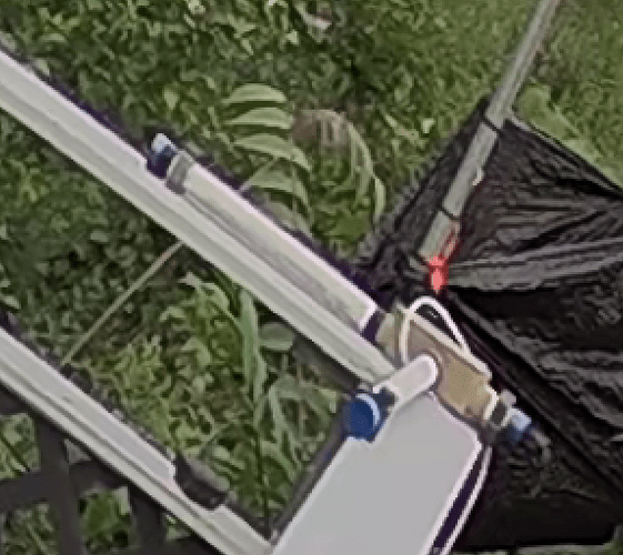

On the few occasions in the past that I went through the old lightningmaps.com server to see what my station was reporting, I noticed that it was used for a few strikes in New Zealand (13,500 Km away), the Cook Islands, Greece, the Mediterranean Sea, and north Africa including Mali. Not bad for two 200mm ferrite rods in some PVC tubing that sits on the corner of our deck railing:
I took my station down three weeks ago, because I’m in the process of relocating my QTH from the land of 2’s to the land of 4’s. When it was online, it was frequently on the first page in the world on that station list above…and sometimes #1 at the top.
One thing that’s interesting for hams is that Blitzortung encourages you to tinker with antenna designs, build magnetic loops, and other fun stuff. The kit doesn’t even come with antennas by default, unless you buy their 200mm ferrites made by a third-party and fashion a housing for them like my hack above…
