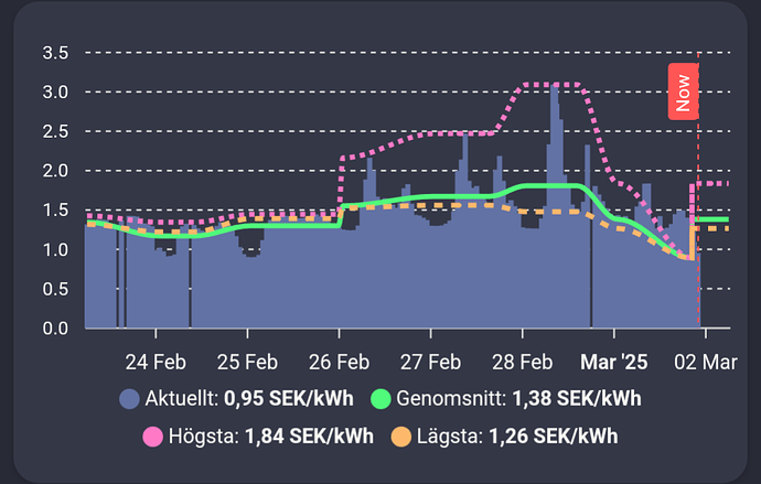

I’m trying to get last prices but also see a few hours ahead but can’t for some reason… Anyone know what I’m doing wrong?
type: custom:apexcharts-card
graph_span: 7d
span:
  start: week
  offset: +6h
now:
  show: true
  label: Now
  color: "#FF5555"
experimental:
  color_threshold: true
header:
  show: false
  show_states: false
  colorize_states: true
  title: sensor.nord_pool_se3_senast_uppdaterad
series:
  - entity: sensor.nordpool_sek_aktuellt_pris_template
    color: "#6272A4"
    stroke_width: 2
    float_precision: 2
    type: column
    show:
      in_chart: true
  - entity: sensor.nordpool_sek_genomsnitt_template
    color: "#50FA7B"
    stroke_width: 3
    float_precision: 2
    fill_raw: last
    show:
      in_chart: true
  - entity: sensor.nordpool_sek_peak_high_template
    color: "#FF79C6"
    stroke_width: 3
    stroke_dash: 3
    float_precision: 2
    fill_raw: last
    show:
      in_chart: true
  - entity: sensor.nordpool_sek_peak_lowest_template
    color: "#FFB86C"
    stroke_width: 3
    stroke_dash: 5
    float_precision: 2
    fill_raw: last
    show:
      in_chart: true
