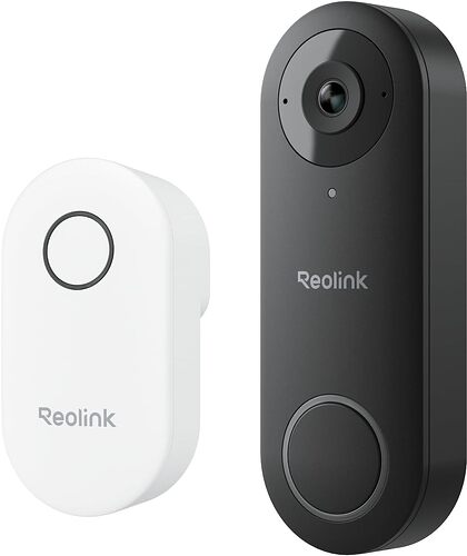

I’m hoping to replace all my blink and ring devices and I’m wanting to start with the video doorbell. I’ve done a bit of searching and reading and the Reolink seems well-thought of with the community so I’m thinking of going that route.
