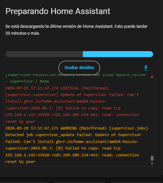

I have satellital internet, with 200mbps down and less than 10mbps up and minimum 600ms of latency, when I try to update normally, it only say timeout and conection reset by peer and didn’t finish
But if system restarts for anything, until supervisor is updated, I not have acces to home assistant in any way, so, if never finish update, never will have access
Then, if I could download manually the image and update from my local disc or shared folder, I can solve it easy

No, it doesn’t work because it need to download supervisor online, I have the same problem

Sorry, but I don’t know how to do it, I download the vdi image (for virtual box) and do all the steps and, when it started first time, appears the screen saying downloading latest version, and this only failed because connection reset by peer (2h before it remains the same)
