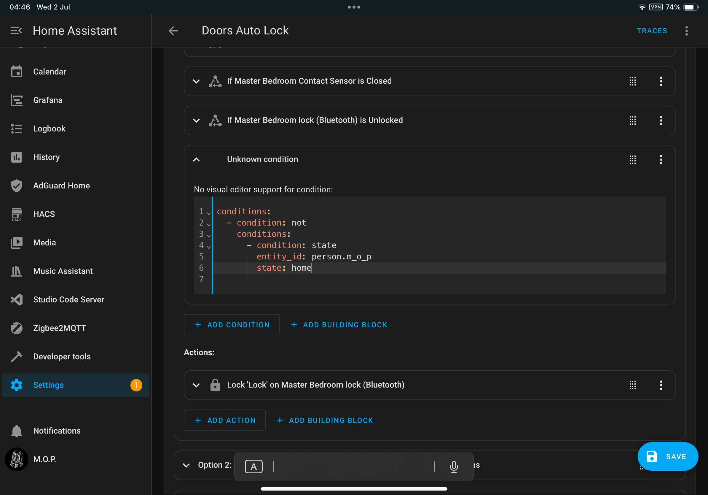

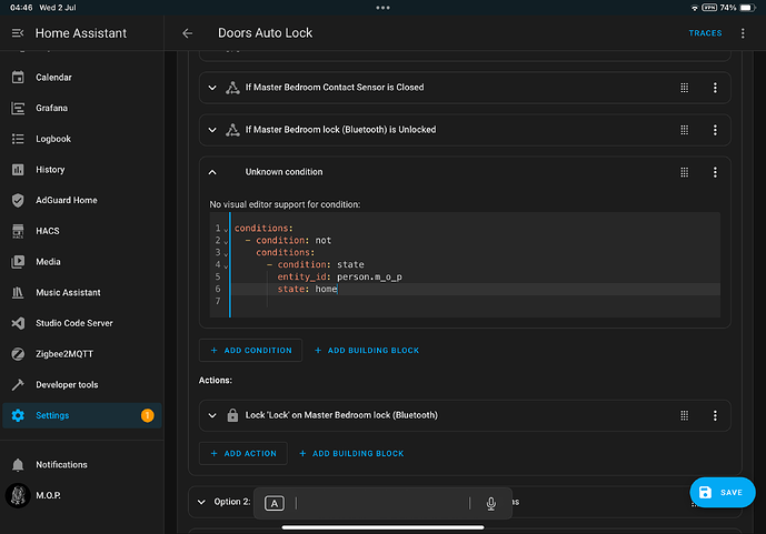

I dont know how to set it to not home. Its not available in UI and in yaml its said unknown condition

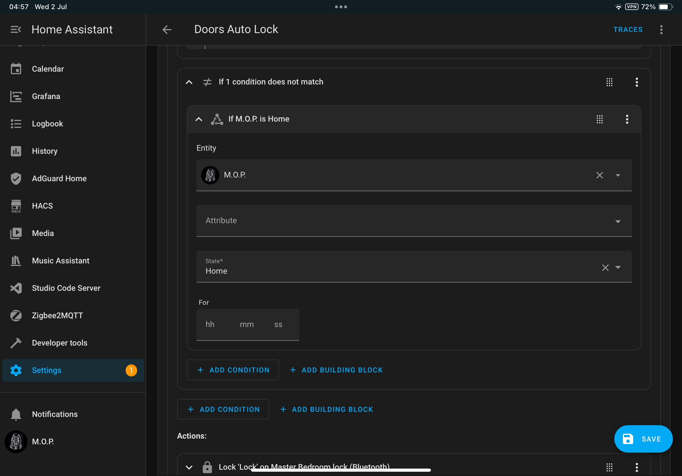

add contition , write “no” select the only option
add condition → entity-> state and select your device
Like this?
yes thats correct, this will cause to pass when you are not at home or any other zone
Thank you so much. It should work now
