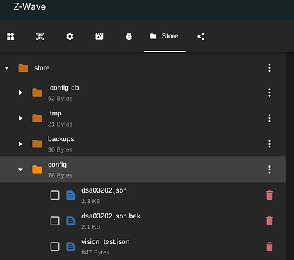

Then you follow the instructions at https://zwave-js.github.io/zwave-js-ui/#/device-support/custom-device-files
You can access the Store directory from the Z-Wave JS UI web UI. Create a config directory and add the files there.
Thanks for your patience with me. It’s sinking in now.
