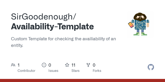

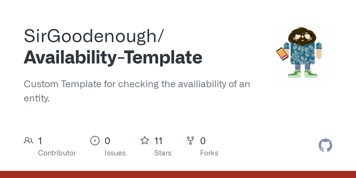

I wrote this a while back and it would work, but there are easier ways. You could look at what this is doing and try that.
