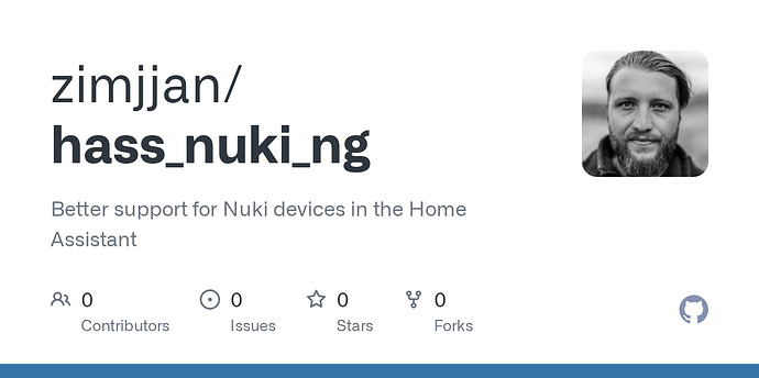

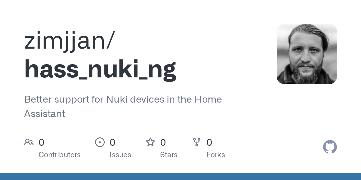

try custom component, where you have more services then core integration.
I don't have the bridge, so I guess polling via web would be consuming much more battery. :frowning:
And looking at the issues, it seems the latest models are not supported. Issues · kvj/hass_nuki_ng · GitHub
I was wondering more about some way to force it via Matter. Or maybe even just Home Assistant UI because it seems for a group of locks, the Open Door button is always shown (even when all locks in the group do not have it individually), though not sure right now if it actually works.
