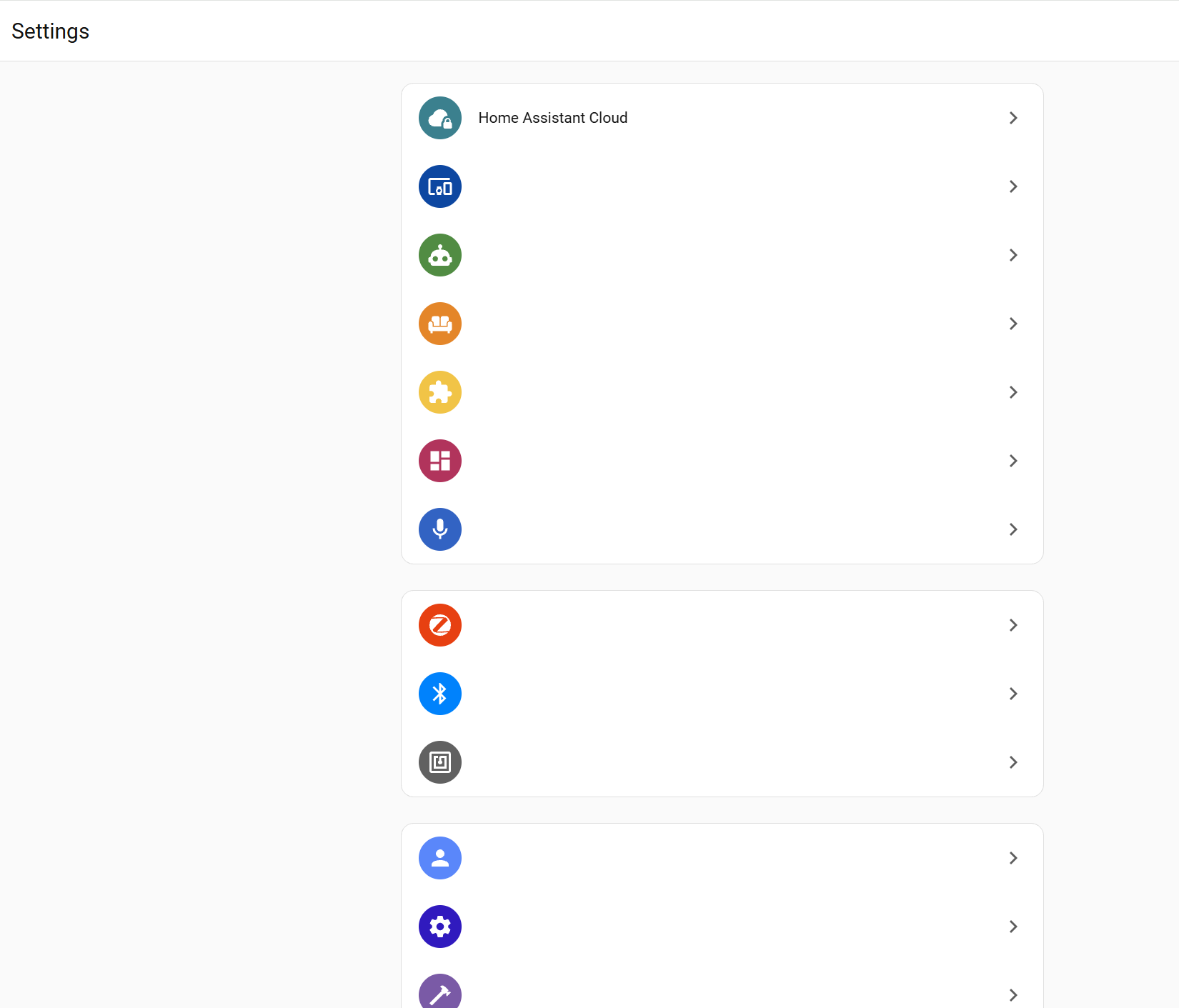

It only happens on the settings page and refreshing instantly fixes it, but it happens every single time where the text is the same colour as the background.

I upgraded to 2026.8.0 and noticed on both my desktop and laptop the settings menu and other pages are not displaying text properly. They may appear, or if not it needs f5 to get the text to appear. I am not running any themes etc, rolled back to 2026.7.4 resolves issue. Then upgraded back to 2026.8.0 and it occurs again. Tried things like incognito mode etc. Screen shot attached.
