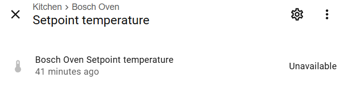

I’ve got a similar issue. I reinstalled the integration, and got some of them back, but as soon as I used my oven I lost my temerature setpoint (which is pretty critical to value when you’re looking at an oven!) and the cavity temperature exists but doesn’t seem to change…
