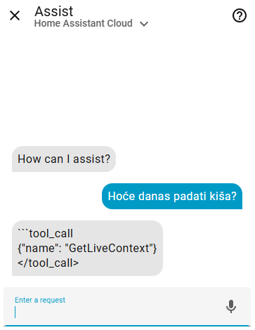

I have the exact same problem with PetrosStav/gemma3-tools:12b as you guys are mentioning. Either is doesn’t detect that it needs to do a tools call, or it just prints out the tools call as plain text.
I’m using it in Croatian language, maybe that is the problem?
As for other models, qwen3:14b work with tool calls, but it’s not as good in Croatian, as gemma. Although better than most othen models I tried.
Also mistral-small:24b works great, but it’s a little too big for me, it fills up 95% of my vram, leaving space for nothing else.
I’d really like to get gemma workings, since it’s small, good at Croatian, and has vision, so I can reuse it for Frigat’s GenAI (instead of running moondream on the side).
