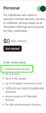

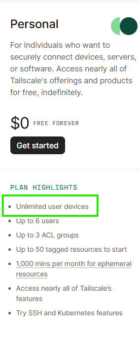

Not sure of what your setup is, nor what you are trying to achieve, but keep in mind that this limit is for devices in your tailnet, i.e. devices having the actual tailscale client installed.
Typically, and specifically for HA, you only install tailscale on your HA instance to reach it from the outside world. HA itself kindof acts as a router, here, and talk all your devices on you local lan.
Actually, not sure where this “100 device limit” comes from
the 100 device limit is stated elsewhere on their site. Tailscale is weird in how they state different things for the same product on the site. I will have over 6 users, so the free service will not work for me.
If you self host, there is a device limit.

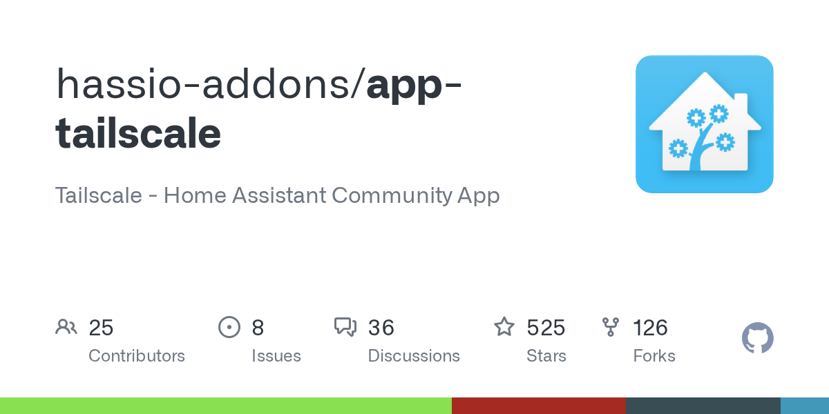

The below is from the tailscale’s git hub page for home assistant. It seems it is the client, and not the server. I want to self host the server side, and the only way to do that is to use headscale.
Home Assistant Community App: Tailscale
Tailscale is a zero config VPN, which installs on any device in minutes, including your Home Assistant instance.
Create a secure network between your servers, computers, and cloud instances. Even when separated by firewalls or subnets, Tailscale just works. Tailscale manages firewall rules for you, and works from anywhere you are.
Prerequisites
In order to use this app, you’ll need a Tailscale account.
It is free to use for personal & hobby projects, up to 100 clients/devices on a single user account. Sign up using your Google, Microsoft or GitHub account at the following URL:
Ok, fair enough. So, back to your initial post.
You don’t have a headscale network, yet, right?
Are you looking for an headscale server app to install on HAOS? A quick google doesn’t seem to bring anything, so I guess you’ll have to install it somewhere else following their installation documentation.
Next, you’ll need to hook up your HAOS to your headscale network.
The same google bring me this: Modify Tailscale integration to support Headscale · home-assistant · Discussion #2213 · GitHub
which tells the current tailscale client app doesn’t work with headscale, and probably never will, so you’ll also need a custom headscale app.
Bottom-line: Not an easy task…

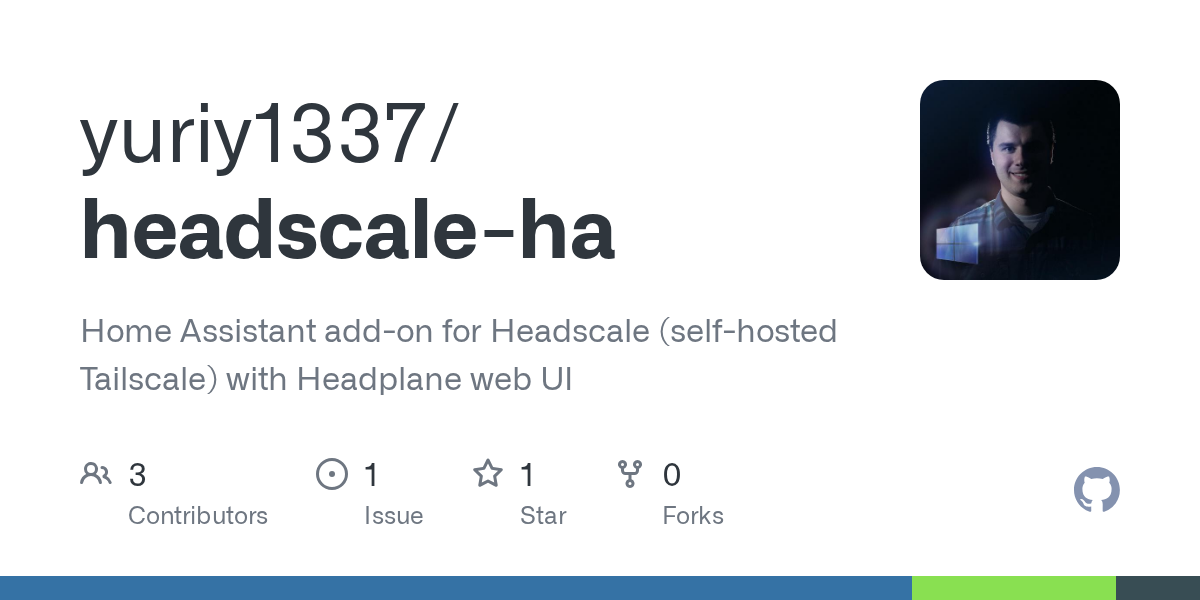

I have headscale server installed. It is installed through a git hub repository. I am not sure if this is the head scale server, or just the client, I thought it was the server, but could be wrong.
My router is on a 192.168.x.x range, and headscale is on a 100.64.x.x range. I do not know how to get into the 100.x.x.x range to do the setup. When headscale is installed onto HA, headscales CLI is not integrated into HA’s CLI.
Headscale does come with a web based gui, even with the port numbers, I do not know how to access it. This is outside my skillset at this time. So it is going to push me to learn.
That’s the server part.
It doesn’t actually brings your HA onto the tailnet, afaict. Looking at the webui should tell you that.
It seems it defines an ingress, so you should be able to access the UI directly from inside the HA UI through the sidebar.
What you miss, as I said above, is the equivalent of the Tailscale app for Headscale, to actually bring your HA onto the tailnet.
Please take everything I say with a grain of salt. I don’t run the software, just looking at documentation.
