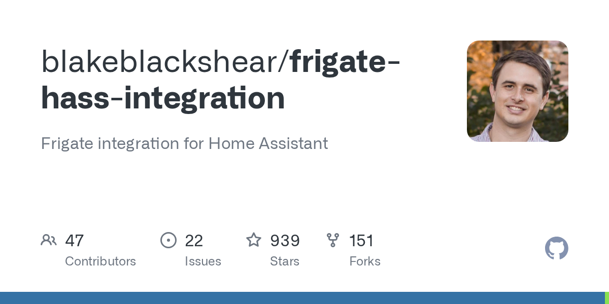

HACS:
That’s how I got mine working with Home Assistant.
That integration connects to my Frigate instance running on an different machine, and it adds the cameras from frigate directly to Home Assistant.
