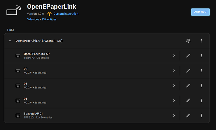

I have flashed the new ESP and it finds the BLE tag, but by some reason the ESP is not added to OpenEpaperLink.
Here I can see the ESP and the new tag in the white boxes but I also get a failed message at the top right corner.
On the other AP I get online.
Is not multiple APs supported?
Or what have I done wrong here?
Figured it out.
Needed to flash the ESP with BLE only firmware.

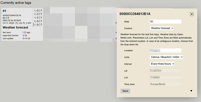

Tags dont run on my HA, dont know why. Access point works, but nothing is displayed via HA.

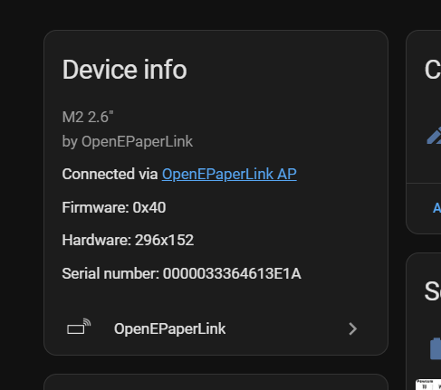

Depending on your version of the integration the target might be wrong.
It probably needs to be device.
Edit confirmed from your previous images.
It has to be device

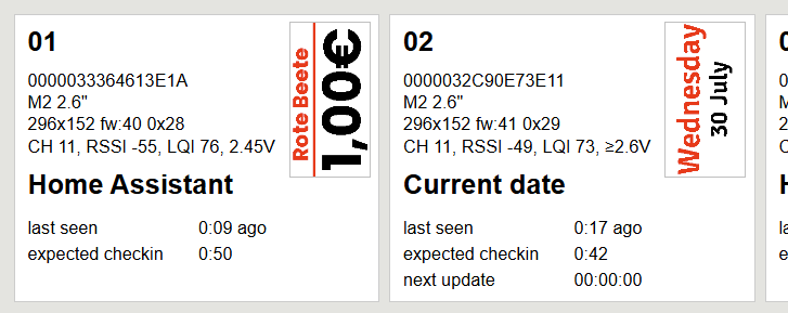

Stop, no i ve “hello world”
Great.
I did not expect that to work since it was missing font and color. But good that it worked.

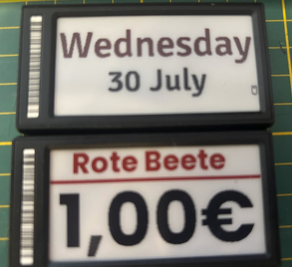

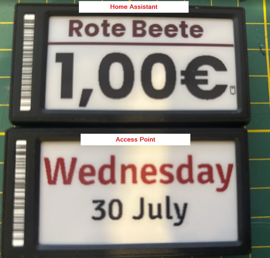

One small problem remains. The red is darker when the text comes from HA. It is better via the access point.
no different between “accent” and “red” as colour

Drawing red color uses more battery, the battery icon on the top tag could be the issue
thx. think you are right
