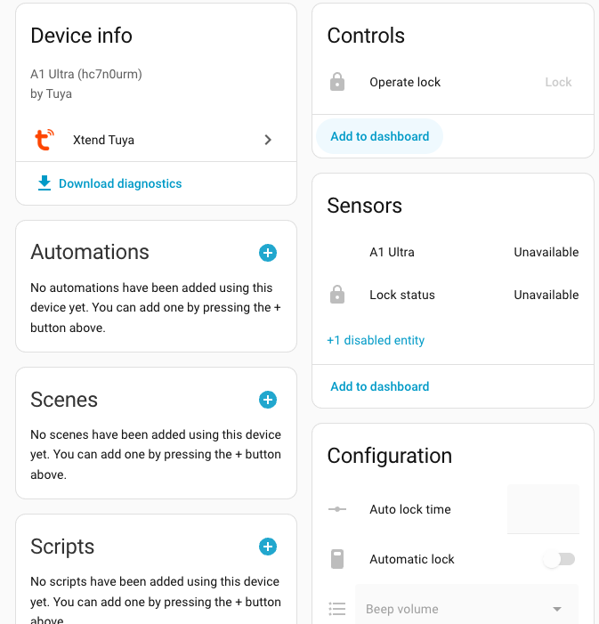

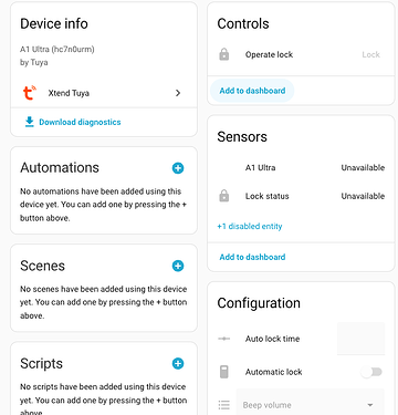

Hi Dany
Iv’e enabled the Smart Lock Open Service and also installed the Xtend Tuya in HA successfully.
I can see the lock in HA but it’s all unavailable (Im not using the tuya gateway, should this work with BLE?):
Thanks
Omer
