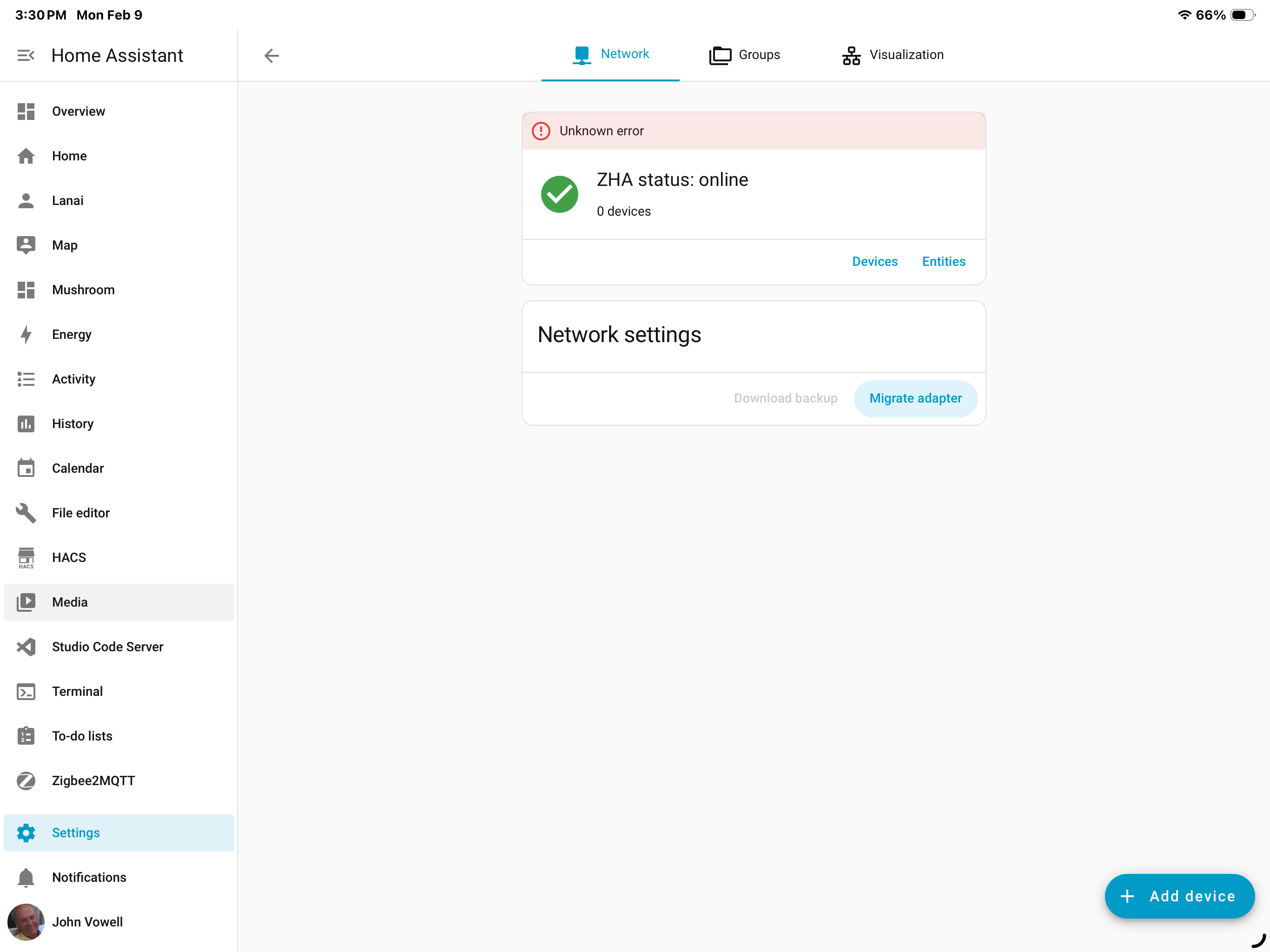

I am trying to migrate from ZHA to Zigbee2MQTT. So far I have managed to disable all my existing Zigbee devices but have not successfully installed Z2M. It would appear that the problem is that ZHA refuses to go away. I can see that ZHA is still online, but there is no way to delete or uninstall it. I have tried deleting all ZHA’s entities, but every device has two entities that cannot be deleted. The Zigbee integration no longer shows up in Devices and services, but if I tap Zigbee in the sidebar, I get the following screen:
As you can see, there is no way to delete or uninstall it. I am at my wit’s end, small that wit may be.

Now you can see why I would like a person to come to my house and see what is happening. I will repeat these things one more time.
  1. There is NO ZIGBEE INTEGRATION IN Devices and services. Hence no three dots.
  2. The only way to access ZHA is through the Zigbee menu option in Settings.
  3. When accessing ZHA in this manner, it says that ZHA is online. In this screen, THERE ARE NO THREE DOTS.
  4. You can see all the devices that were originally connected to ZHA, but there is NO DELETE OPTION for any device.
  5. You can display the entities in the ZHA screen and delete them one by one, but two entities do not have a delete option. It is grayed out. These entities are LQI and RSSI. I have done this, but it does not seem to have had any effect.

I’ve responded to you in the other topic you have on this issue, can you check if my guess is right? I believe the integration you are showing is not ZHA but coordinator related. Can you confirm? What coordinator is this?

There are two things related to zigbee in HA - the adapter/coordinator/radio and the ZHA integration. Well I guess technically three things if you include zigbee2mqtt but that is an add-on provided by a third party and not built-in to HA
The coordinator is the hardware part. That’s what allows your zigbee devices to communicate back to the host. That host can either use the ZHA integration or the zigbee2mqtt add-on. But only one of those things can access the coordinator at any time. Once one of those binds to the coordinator then the other one is blocked from binding to it. It essentially gets locked to the ZHA integration or the zigbee2mqtt add-on until you unlock it.
You don’t want to delete the coordinator entry from the zigbee section of the settings menu. That is simply telling you that HA found a coordinator connected to you system.
If the ZHA integration is nowhere in your system (no longer in the integrations section of settings) then you should just be able to reboot your HA machine to unbind the coordinator from ZHA. (if your system auto-discovers your coordinator and tries to re-bind it to the ZHA integration you should just be able to ignore it and not configure the ZHA integration).
Then you can install the zigbee2mqtt add-on and configure it to use your (now free) zigbee coordinator.

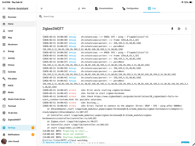

I have reached the point where there is a Zigbee2MQTT entry on my sidebar. Clicking that displays the Onboard screen. No matter how I fill out the form, it does not complete. It gives the error “Unable to start Zigbee herdsman. Here is the log output.
The log says that z2m can’t connect to the adapter. I think that’s the ultimate issue.
usually that means that the adapter is bound to another service - usually in this case that would be ZHA or at least HA in some way. But you say you don’t have ZHA anywhere in your system so then I don’t know how that’s possible.
