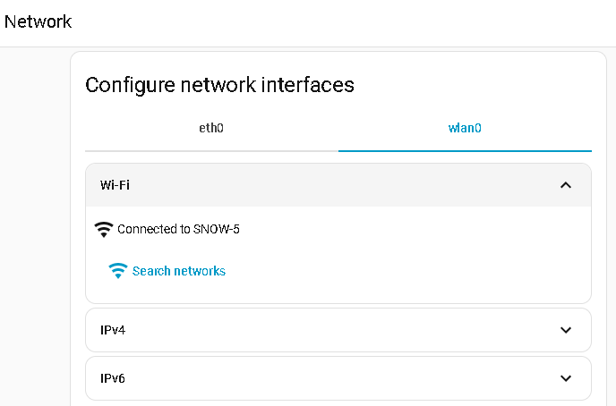

Well I got my Pi5 the other day :slight_smile: Cute little piece of hardware. And yes, the 5GHz WiFi works, so ty once again to the two people who reported it worked on the Pi4 and 5. I’m guessing since the 3B and 3B+ use the same image, it’s disabled in the software bc “reasons”. The 3B+ has 5GHz support while the older 3B does not.
