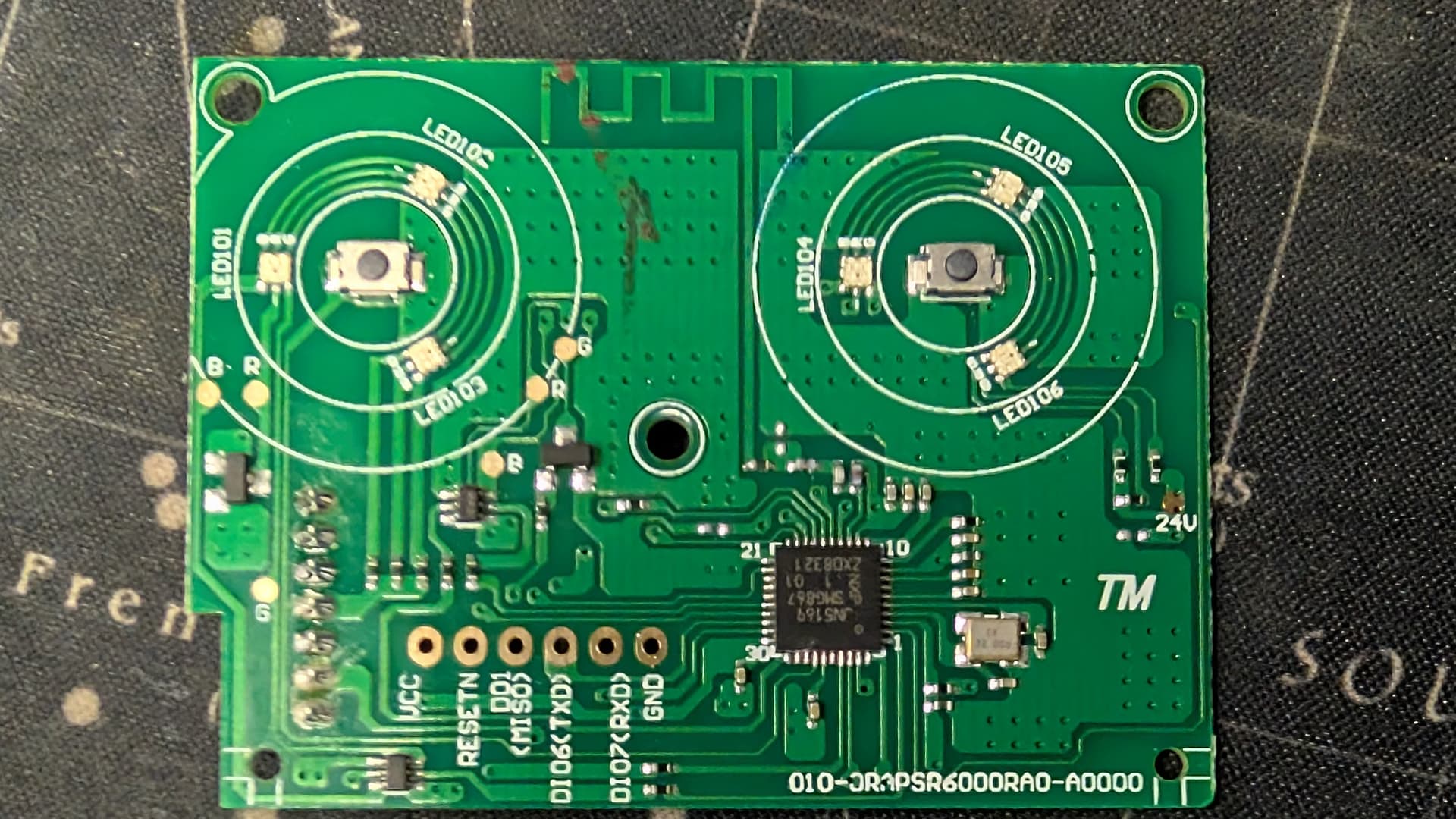

EDIT: just had a look inside the socket and there are 3 RGB leds per side. I scratched the track to the RED led and now it works like - Off, no light, On, blue. Much better as red when off is confusing

Yes I agree. Looking at the PCB, there are programming pins for the JN5169 ZigBee chip but no idea how to change the firmware.

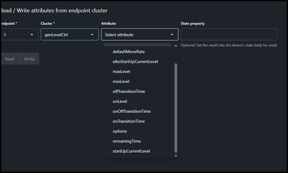

Maybe theres a clue in the exposed zigbee cluster information? I dont have mine installed as of yet, but was doing a test with it last night simply on my desk so i have no working experience of them…
