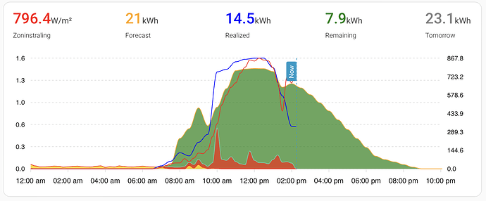

Hi, I have combined my daily electricity usage / production with the Solcast prediction and solar intensity from my Garni weatherstation in an Apex chart. It’s really nice as it shows clearly what I import and what I use from the sun, relative to the predicted and actual sun intensity. So it basically tells me how well I’m using the sun’s energy.
I’d like however to add the time stamp from Solcast which moment of the day my production will be highest. So for example a little flag when the production is maximum. I’m really struggling how to get this into my apex chart, any ideas?
I’ve posted some screens below. So in short I want to add the specific timestamp to the graph.

This is how the graph looks like

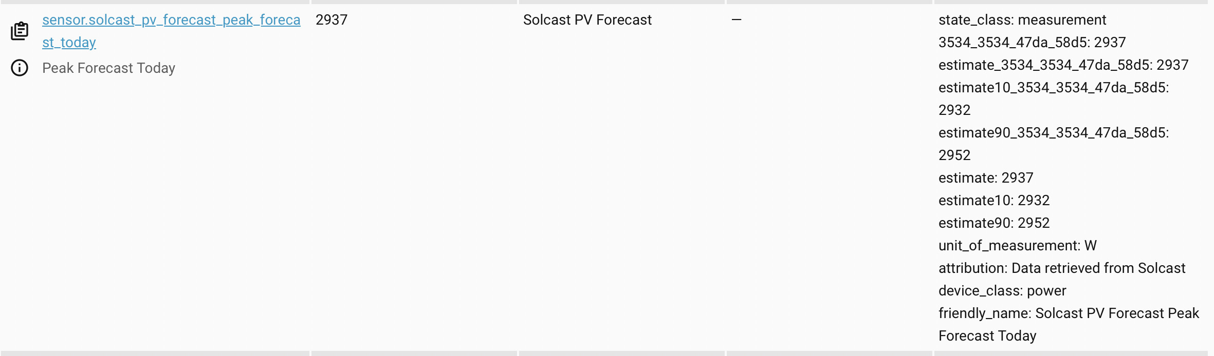

The first challenge I see is that your solcast sensor does not present a timestamp so where would this come from?
The second is that annotations can not easily use an ‘x’ value from another entity, there are some workaround but ugly (or: ‘creative’) :slight_smile:
Or do you mean your actual (!) max production, not the solcast-forecast projected maximum, in that case you can add this to your (each) entity within the series section
    show:
      extremas: max+time
