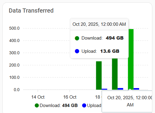

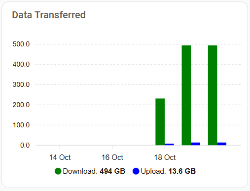

I use apex chart to display history of my download usage per day.
But if i check why today data is incorrect, we can see the value is 494 for download based in this picture

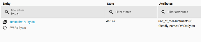

but the sensor return around 440

Looks like your sensors are not resetting exactly at midnight but a bit after. Share the history graph for sensor.fw_rx_bytes zoomed in to around midnight.
Try changing that to func: last
Also in future please: https://community.home-assistant.io/t/how-to-help-us-help-you-or-how-to-ask-a-good-question/114371#oneone-format-it-properly-16
hi @tom_l
Seem change to ‘last’ is working, let i monitor for some days.
