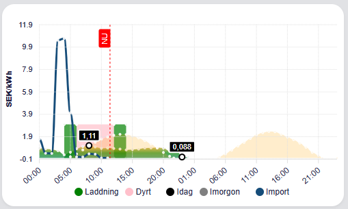

I’m working on an Apex chart to show the energy price, charge interval, and expensive price interval. So far, so good – but when I add my sensor that shows the energy I buy from the grid, things get a bit messy.
When I charge the car, the import series goes up (which is expected), but it affects the rest of the graph (data from my other series get so smal) I tried putting the import series on a separate y-axis, but then the “now” marker was pushed outside the visible area.
Is there a way to adjust my code so that the import line doesn’t affect the scaling of the rest of the graph? I just want to show how much energy I buy from the grid without letting it distort the overall chart.

You could use a different y-axis for import… have a look in the docs or try searching this long post, which is btw the best place to post things as it is on the notif list of multiple people
ApexCharts card - A highly customizable graph card - Share your Projects! / Dashboards & Frontend - Home Assistant Community
I tried that but when it got messy and now was outside the chart.
Thaks for that post tip. I will post it there instead.
Did u solv it? Can u share the code?
