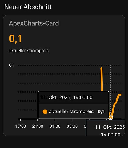

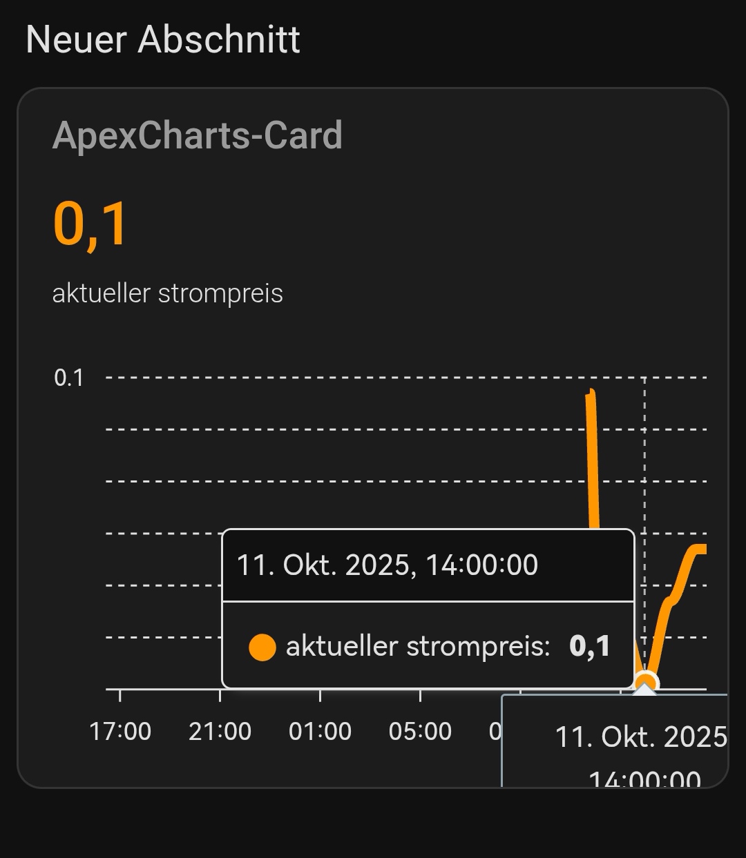

So i read out current price from nordpool. I made a template Sensor that shows now 0.078 as result .If i make a apex Card the value Always Shows 0.1, but the curve is correct , it rises and falls …so it rounds only the value as i move through the curve to 0.1.
Any idea how to fix that and force apex to show all 3 decimals for the value?
Thanks a Lot for Help!
Take a look at float_precision in series options.
Thanks a lot darryn ! …float_precision: 10 did the thing.
