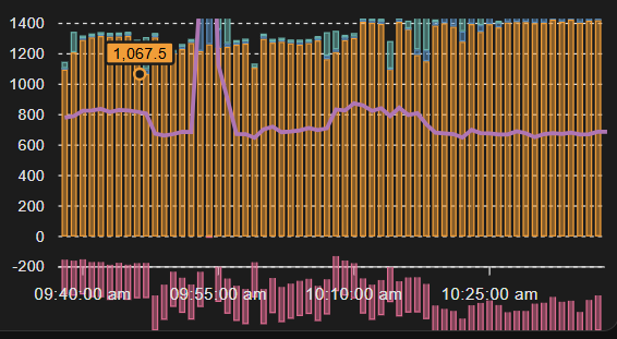

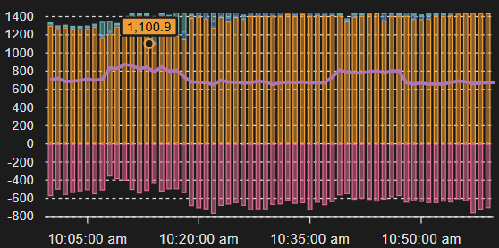

I’m seeing same issue since updating apexcharts-card yesterday to v2.2.3.
I only have one negative (invert=true) series. Previously - the bars would be drawn all the way from y=0 to y=value. Now there is a gap, which looks ugly.
I have noticed that the bar lengths all looks the same ~200, which coincidentally matches the β€œmin” value for the y axis. Perhaps the code is trying to clip the bars to β€œmin” - but wrongly clipping the wrong end of the bar.
So I have a work around. Change y-axis β€œmin” value to be large enough:
But would prefer the earlier behavior where bars could correctly draw past the y axis min value.
