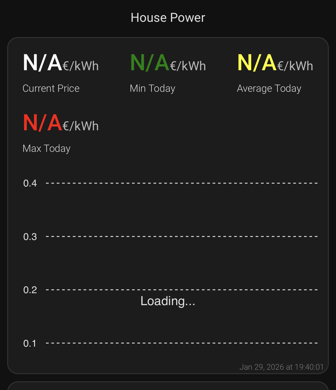

Apexchart Nordpool "Loading..."
My chart works somewhat, thanks for all examples in this forum. I noticed that I’m not the only one having “Loding…” problem when opening the given HASS view.
This Loading…
  • happens in both desktop and mobile, mobile is worse
  • it typically loads after minute or more if I keep waiting
  • it loads instantly if I change tab and come back
  • before updates and changes, it didn’t hang like this
Maybe this is version specific, how I can see the apexchart version?
Tuju
Well well well, it looks like it was caused template triplicates, I used the instructed template to create today and tomorrow Nordpool prices - and for some reason ‘Electricity Prices Tomorrow’ template had Tomorrow2 and Tomorrow3 entities, and the actual one without numbers was empty.
Settings → Devices → Entities
  • activated selection boxes
  • selected extra ones
  • Up right corner menu: Delete selected
Then I had to wait the next day 14.00 a clock when the new prices are released and template populated that correct entity.
I think I still see the Loading… problem before that release time, so I guess the template should return an empty list or something so that Apexchart would just loop empty and show nothing until release time.
