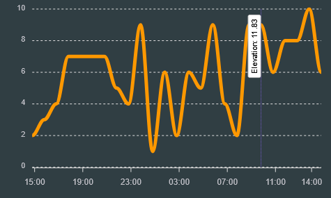

Another approach is to wrap the chart in another card, which adds support for JavaScript templates and entity states. I use custom:button-card for this, and for a simple annotated chart, it would look like this:
type: custom:button-card
styles:
  card:
    - padding: 0px
  grid:
    - display: block
custom_fields:
  chart:
    card:
      type: custom:apexcharts-card
      apex_config:
        annotations:
          xaxis:
            # minus 5 hours
            - x: EVAL:new Date().getTime()-1000*60*60*5
              borderColor: "#775DD0"
              label:
                style:
                  color: black
                text: |
                    /* button-card template syntax; can be used for every field, e.g. instead of EVAL:... */
                    const sunElevation = states['sun.sun'].attributes.elevation;
                    return 'Elevation: ' + sunElevation;
      series:
        - entity: sun.sun
          data_generator: |
            const now = new Date();
            const data = [];
            for(let i = 0; i <= 24; i++) {
              data.push([now.getTime() - i * 1000 * 60 * 60, Math.floor((Math.random() * 10) + 1)])
            return data.reverse();
