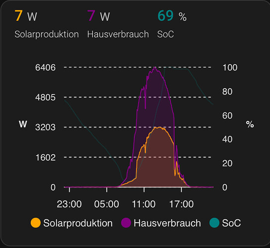

Thanks for all your help. But unfortunately, it still won’t show me the line n the diagram. No matter what I change or do. It does not show up. :frowning:
I checked “sensor.plenticore_plus_10_battery_soc” and it is saved as a number.
type: custom:apexcharts-card
apex_config:
  chart:
    height: 230px
  legend:
    show: true
yaxis:
  - id: left
    min: ~0
    max: ~500
    decimals: 0
    apex_config:
      tickAmount: 4
      forceNiceScale: true
      title:
        text: W
        rotate: 0
  - id: right
    show: true
    opposite: true
    min: 0
    max: 100
    decimals: 0
    apex_config:
      tickAmount: 5
      title:
        text: "%"
        rotate: 0
      yaxis:
        labels:
          formatter: |
            EVAL:function(value, { seriesIndex, dataPointIndex, w }) {
              return "% " + parseFloat(value).toFixed(1)
all_series_config:
  stroke_width: 1
  float_precision: 0
  show:
    in_header: raw
    legend_value: false
  opacity: 0.2
  statistics:
    type: mean
    period: 5minute
span:
  end: minute
graph_span: 24h
header:
  show: true
  title: ""
  show_states: true
  colorize_states: true
  floating: false
series:
  - entity: sensor.plenticore_plus_10_sum_power_of_all_pv_dc_inputs
    color: orange
    yaxis_id: left
    type: area
  - entity: sensor.plenticore_plus_10_home_power
    color: purple
    yaxis_id: left
    type: area
  - entity: sensor.plenticore_plus_10_battery_soc
    color: teal
    yaxis_id: right
    type: line
experimental:
  disable_config_validation: false
card_mod:
  style: |
    div#header__title {
      font-size: 18px;
      margin-top:0.25rem;
      margin-bottom:0.5rem
    div#header__states {
      justify-content: start;
    div#state__value #state{
      font-size: 18px;
      padding-right:5px
Using your code by using my sensors will get a nice chart…
Strange, it does indeed work for you. :grin:
I’m now creating my chart from scratch. Let see if I can sort out the issue.
probably it’s because of your SOC-sensor
I just found out its because of this:
  statistics:
    type: mean
    period: 5minute
when I remove it, the line does show up.
my SoC sensor does not like those lines, so I added them just for my other two sensors.
Now it’s looking the way I want.
Not all sensors create statistiscs of all types … you can doublecheck this with the statistics graph

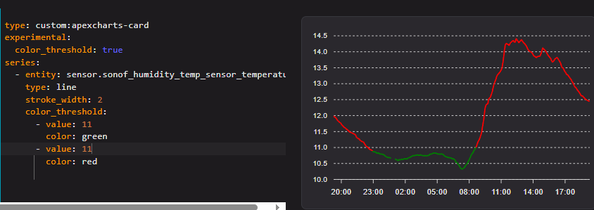

This seems like a very simple thing, but I can’t for the life of me find an answer…
Is there a way to create an area graph with the origin / fill area centered on something other than zero? I’m trying to make a weekly temperature area graph where the line/area is one color when the temperature is above freezing and a different color when the temperature is below freezing.
The graph itself and the color thresholds weren’t too hard to figure out, but the fill area on the graph always center and fill to the zero line. I’m a backwater American though and freezing in Farenheit is 32 - I’d like the fill area to “center” on 32 rather than 0.
Show code and card ?
Code:
graph_span: 7d1s
span:
  end: day
header:
  show: true
  title: Weekly Temperature
  show_states: true
series:
  - entity: sensor.ecowitt_wh90_outdoor_temperature
    color_threshold:
      - value: 32
        color: blue
      - value: 33
        color: darkorange
    stroke_width: 2
    fill_raw: last
    curve: smooth
    type: area
experimental:
  color_threshold: true
Graph currently looks like this:
What I’m trying to achieve:
This will not work as it fills below the line and you want a combination of above and below. Only option (that I know of) is via ‘line’
EDIT: yes…it does work indeed but only for the below 0 ones…now I get your point…will have a look
It is a bit fiddly as I had to fake a below-zero graph
I am tweaking both the series values as well as the yaxis ones… maybe you can bake cake with this :slight_smile:
i.e. bring the graph below 0 first, then apply the threshold. then fake the yaxis back to Fahrenheit
Clever idea. It seems to have worked visually in that the lines sit in the correct place on the graph, and fill above and below the way I wanted.
The problem now is that if you mouse over the graph to see the temperature value at a specific time, the rollover text will show the modified values (like -3 F), so that’s a bit confusing.
Also that can be tweaked but you have to search in this loooong post. It will however become one tweak after the other and it becomes less and less to manage. For one card OK but …well
EDIt, this issue has nothing to do with F vs C but with values above/below 0
