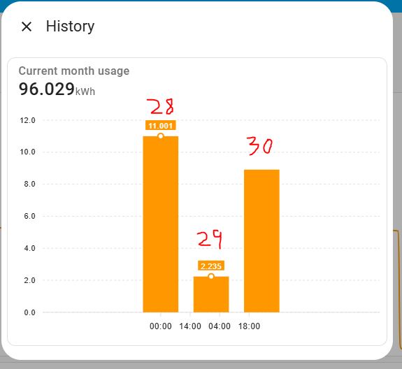

hi guys, my graph is calculated per day and I face a new issue now. It seems that the X axis labels are only correct for min span of 4 days and above. If it is below 4 days, the X axis labels are weird. How should i make it to display only dates?
span = 1d
span = 2d
span = 3d
span = 4d

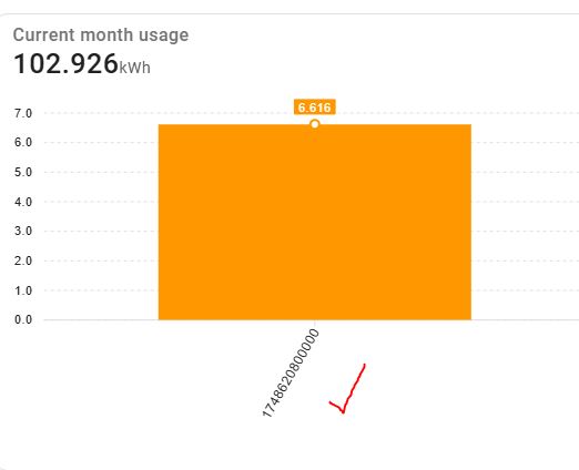

if i use xaxis.type: category, then i will get the correct ticks and alignment but how do i convert the timestamp value back to dd MMM? The formatter function does not seem to work.
picture for span of 1d:
# lovelace_gen
type: custom:apexcharts-card
header:
  show: true
  title: {{ chart_title }}
  show_states: true
  colorize_states: false
graph_span: {{ chart_span }}
span:
  start: day
  offset: {{ chart_offset }}
apex_config:
  # tooltip:
  #   x:
  #     format: dd MMM
  xaxis:
    type: category
    labels:
      # format: dd MMM
      # formatter: |
      #   EVAL:function(value,timestamp) {
      #     return "123";
      showDuplicates: false
      rotate: -60
      rotateAlways: true
      # hideOverlappingLabels: false
    # tickAmount: 1
    tickPlacement: on
    # title:
    #   text: Date
    # axisTicks:
    #   show: true
series:
  - entity: {{ chart_entity }}
    type: column
    group_by:
      func: max
      duration: 1d
    float_precision: 3
    show:
      extremas: true
      in_header: false
  - entity: {{ chart_header_entity }}
    show:
      in_chart: false
      name_in_header: false
    float_precision: 3

if i use type: datetime, the xaxis labels are wrong if my span is less than 4 days
You are looking in the wrong direction, not saying there are no issues with this chart. start simple and remove e.g. span: start: day, no offset, etc. it is quite a challenge to guess why this goes wrong without having the same dataset

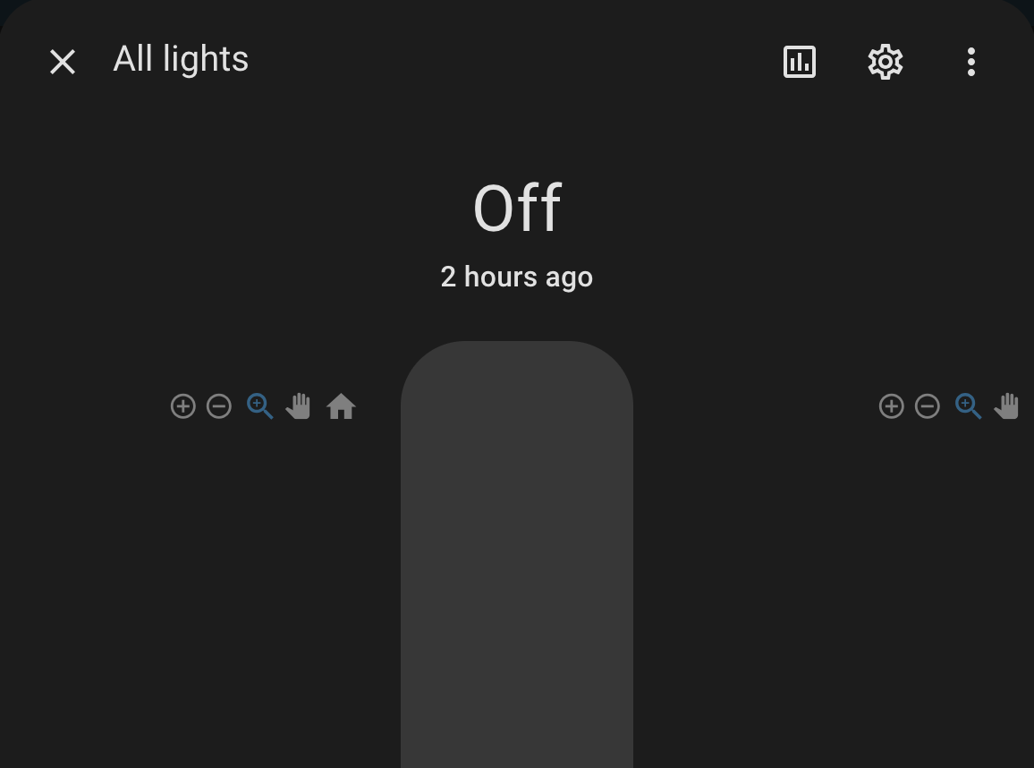

I found a possible bug where the toolbar icons from apex chart overlay on top of other windows. Is there a way to avoid this?
Below is a more info window from a Tile Card. HA 2025.5.3, apexcharts-card v2.1.2 via HACS. It occurs in both desktop browsers and the mobile app.
Code:
graph_span: 14d
span:
  offset: +0s
header:
  show: false
apex_config:
  chart:
    zoom:
      enabled: true
      type: x
      autoScaleYaxis: true
    toolbar:
      show: true
      tools:
        zoom: true
        zoomin: true
        zoomout: true
        reset: true
        pan: true
        download: false
  legend:
    show: false
    floating: false
  tooltip:
    show: true
  xaxis:
    tooltip:
      enabled: false
yaxis:
  - id: first
    decimals: 0
all_series_config:
  stroke_width: 1.5
series:
  - entity: sensor.humidity
    color: "#e6194b"
    statistics:
      type: mean
      period: hour
card_mod:
  style: |
    ha-card.type-custom-apexcharts-card {
      overflow: visible !important;

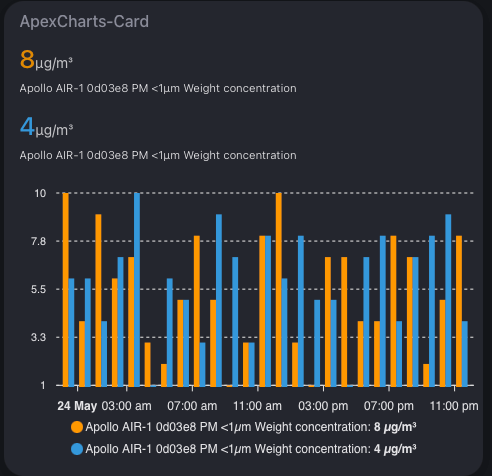

What can I do to prevent the Column width to change over time?
like on 10:01 they are slim and on 10:59 they are wide.
      type: column
      group_by:
        func: avg
        duration: 1h
FOUND THE REASON
it happens when
extend_to: now
is used
I recommend using
extend_to: false
until its fixed
Not sure if one would call this a bug but imo it is…likely this is related to not having the same datetime values.
One solution I found is to group all entities the same way (not ‘raw’ and same duration) but this may disturb the others… trial/error
not sure if I got it right.
under the entitys I removed all
      group_by:
        func: avg
        duration: 1h
and then added this
  all_series_config:
    group_by:
      func: avg
      duration: 1h
But I see no difference in the behavior. The columns are still changing in width over time.
I never use all_series_config so no clue how that behaves, I only saw that having the same duration grouping resolved things for me, maybe not in all cases, start with simple code, donot use formatting/trickery and work your way upward, adding 1 series at the time…no guarantees and do note that Romrider is not responding since ages
Try this too
apex_config:
  plotOptions:
    bar:
      columnWidth: 20
Thanks I will try it
