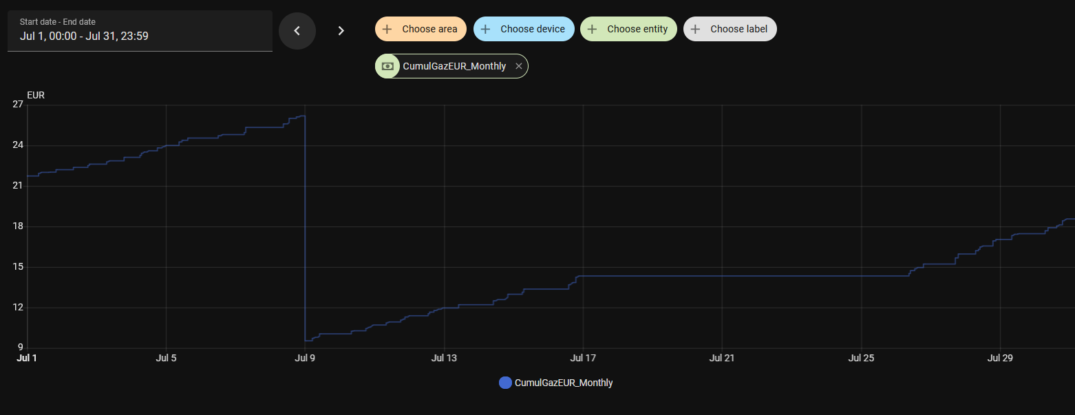

I track my forseen electricity and gaz bill using :
  • a raw sensor that get the live m3 index
- sensor:
      device_class: gas
      state_class: measurement
      unit_of_measurement: 'm³'
      state: >
        {{states.sensor.weshomeval.attributes["java"][36]["value"]|replace('m3','')|float }}
  • a utility meter that collects and reset at the time my gaz provider stop and start the monthly bill
  monthly_bill_gaz:
    source: sensor.consogaz
    name: Monthly Bill Gaz
    cycle: monthly
    offset:
     days: 9
  • finaly, a template sensor, that calculate based on the used m3 and some pricing stuff, the monthly bill.
  - sensor:
      unique_id: CumulGazEUR_monthly
      unit_of_measurement: "EUR"
      state_class: total_increasing
      device_class: monetary
      state: >
        {{ ((states('sensor.monthly_bill_gaz')| float * states('sensor.cumulgazkwh') | float)) + states('sensor.te_cout_mensuel')| float }}
I wanted to generate a graph based on CumulEDFEUR_Monthly, showing for each month of the year the bill.
which is basicaly the last state before the reset.
I do have the LTS showing up in history graph (screenshot for july)
but every attempt with apex failed and I gues it’s because i can use any min, max option of ‘statistics’
    statistics:
      type: max
      period: month
    group_by:
      func: max
      duration: 1month
because I obviously don’t have those since i’m using a total_increasing sensor (right ?)
does anyone have an idea ? that doesn’t need to create another sensor, because I won’t be able to display past data.
Thx a lot

Yes there are data since 2024 at least.
no the probleme is really that I can use MAX, and that I reset my utility meter on the 12th of each month
I tried with data generator but it did not work.
Or I could not make it work, and then I gave up after spending my whole saturday (sunny one …) :smiley:
What did you try? For statistics, assuming you want the ‘max’, this should work (as-in: present data) … you may want to change the period
series:
  - entity: sensor.poele_on_daily
    unit: h
    type: column
    statistics:
      type: max
      period: day
    stroke_width: 1
    float_precision: 2
    show:
      extremas: false

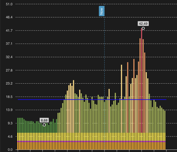

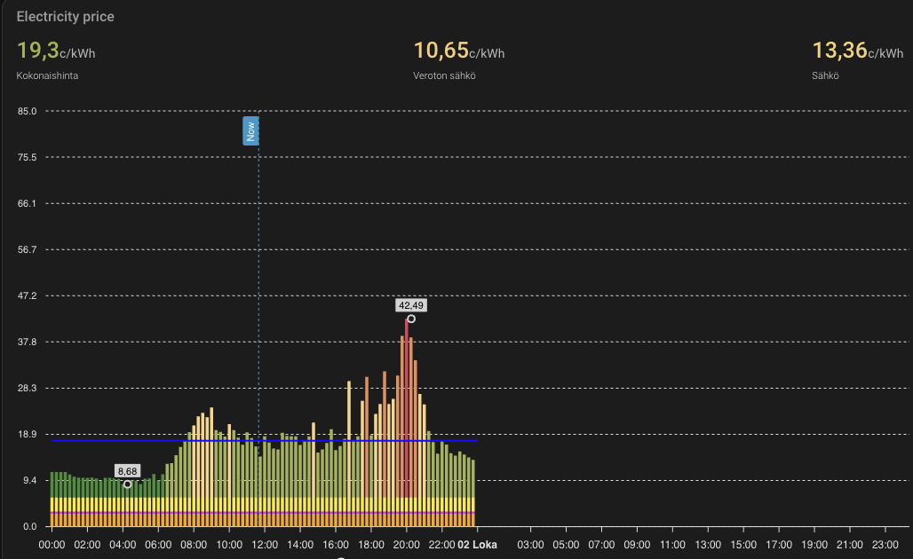

Hi everyone, I’ve setup a graph showing today’s and tomorrow’s (once they are available) electricity prices with separation of taxes, transmission fees and so on.
I haven’t managed to get the maximum to scale nicely though. I’m hoping that it’s just something that I’m missing and a new pair of eyes will spot what needs to be adjusted, as you can see from the picture there is way too much space in the Y-axis wasted:
type: custom:apexcharts-card
graph_span: 48h
stacked: true
apex_config:
  yaxis:
    forceNiceScale: true
    min: |
      EVAL: function(min) { return min }
    max: |
      EVAL: function(max) { return max }
experimental:
  color_threshold: true
show:
  last_updated: true
header:
  title: Electricity price
  show: true
  show_states: true
  colorize_states: true
span:
  start: day
all_series_config:
  type: column
now:
  show: true
  label: Now
series:
  - entity: sensor.sahkon_hinta
    show:
      in_header: true
      header_color_threshold: true
      in_chart: false
    type: column
    color: lightgray
    float_precision: 2
    stroke_width: 0
    transform: return x*100
    unit: c/kWh
    color_threshold:
      - value: 0
        color: 368f39
      - value: 15
        color: a3b34d
      - value: 20
        color: ffd57e
      - value: 25
        color: f18c56
      - value: 30
        color: de425b
      - value: 40
        color: c40423
  - entity: sensor.nordpool_kwh_fi_eur_5_095_0
    show:
      in_header: true
      in_chart: false
    type: line
    color: lightgray
    float_precision: 2
    stroke_width: 0
    unit: c/kWh
    color_threshold:
      - value: 0
        color: 368f39
      - value: 4
        color: a3b34d
      - value: 10
        color: ffd57e
      - value: 15
        color: f18c56
      - value: 20
        color: de425b
    show:
      in_header: true
      in_chart: false
    type: line
    color: lightgray
    float_precision: 2
    stroke_width: 0
    transform: return x*100*1.255
    unit: c/kWh
    color_threshold:
      - value: 0
        color: 368f39
      - value: 6
        color: a3b34d
      - value: 14
        color: ffd57e
      - value: 24
        color: f18c56
      - value: 34
        color: de425b
  - entity: sensor.shf_electricity_price_now
    stack_group: hinta
    opacity: 1
    show:
      in_header: false
      extremas: false
      legend_value: false
    type: column
    color: orange
    float_precision: 4
    unit: c/kWh
    data_generator: |
      return entity.attributes.data.map((d, index) => {
        return [d["Timestamp"]*1000, entity.attributes.transmission_price*100];
    stack_group: hinta
    show:
      in_header: false
      extremas: false
      legend_value: false
    type: column
    color: eb2fdb
    float_precision: 4
    unit: c/kWh
    data_generator: |
        return [d["Timestamp"]*1000, entity.attributes.electricity_margin*100];
    show:
      in_header: false
      extremas: false
      legend_value: false
    type: column
    stack_group: hinta
    color: ffe92b
    float_precision: 4
    unit: c/kWh
    data_generator: |
        return [d["Timestamp"]*1000, entity.attributes.electricity_tax*100];
    show:
      in_header: false
      extremas: false
      legend_value: false
    type: column
    stack_group: hinta
    color: lightgray
    float_precision: 4
    unit: c/kWh
    data_generator: |
        return [d["Timestamp"]*1000, d["PriceWithTax"]*100];
    color_threshold:
      - value: 0
        color: 368f39
      - value: 6
        color: a3b34d
      - value: 14
        color: ffd57e
      - value: 24
        color: f18c56
      - value: 34
        color: de425b
    opacity: 0
    show:
      in_header: false
      extremas: true
      legend_value: false
    type: column
    stack_group: hinta
    color: lightgray
    float_precision: 2
    unit: c/kWh
    data_generator: |
        return [d["Timestamp"]*1000, d["TotalPrice"]*100];
    unit: c/kWh
    show:
      in_header: false
      extremas: false
    type: line
    color: blue
    float_precision: 2
    stroke_width: 2
    data_generator: >
      return [[start, entity.attributes.today_avg*100], [moment(end).subtract(1,
      'days'), entity.attributes.today_avg*100], []];
Thanks in advance.
Have you tried this?
max: ‘|+10|’: The max of the data in the series is 32, then the y-axis max will be 42 (= 32 + 10)
Yup, not sure which entity messes it up but it doesn’t seem to interpret the values correctly:
This is only with the change of
max: '|+10|'
That did however give me the following idea, if I adjust the formula:
 max: |
      EVAL: function(max) { return max-(max/2.5) }
This is the result:
Much better :+1:

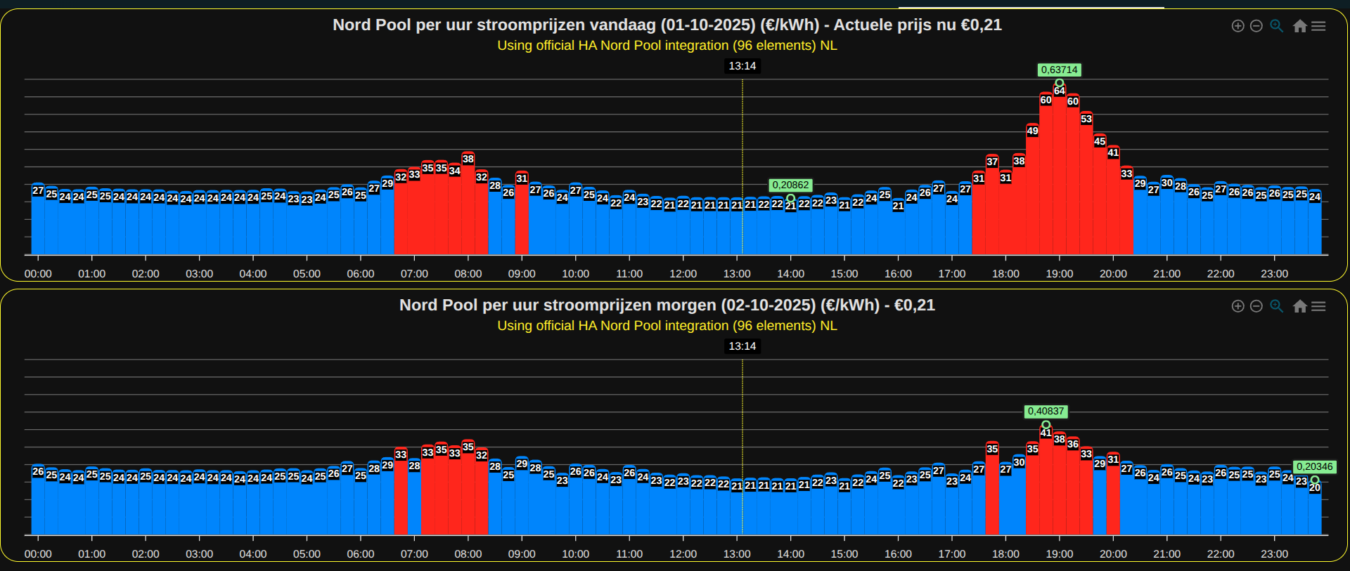

And here’s my take on our new 15 minute scenario
Noting that this only works properly outside of apex_config…i.e. on yaml-root-level
yaxis:
  - max: "|+10|"
